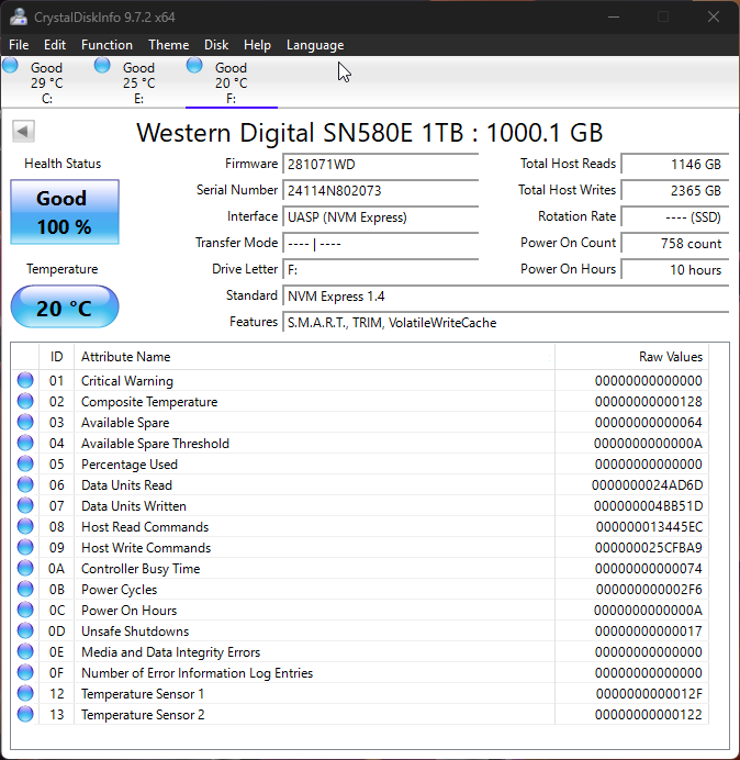

4) as another sanity check, have you tried something like CrystalDiskInfo (Windows) or running ` smartctl -a /dev/sdX ` (Linux) and made sure there's no concerning SMART values with regards to things like wear leveling, available spare %? (err... though if you're not having issues in Linux then points 3 and 4 are actually less likely I suppose)

Sicklyboy i don't even know what I am reading here lol

Hmmmm everything looks totally OK there, so drive is physically in good operational health (critical warning = 0, available spare = hex 64 (100%), percentage used = 0%). I'd go back to my #1 check and make certain that it's connected to a USB 3.x/ "SS USB" port (if you haven't already verified that)
