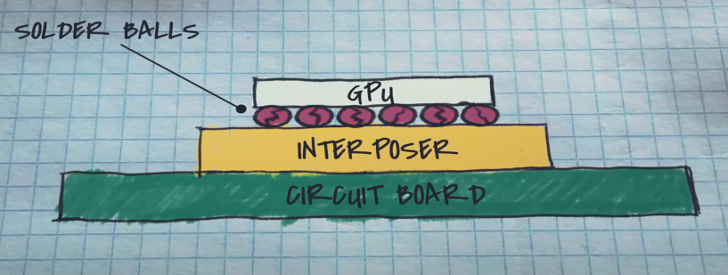

It would be helpful if you could give some details which alternative dashboard you're using.
Maybe all you need is to delete you alternative dash and start with a fresh copy of FSD/Aurora.
maybe try a different HDD.
If the APU is dying there is no way to fix it permanently by reflowing or reballing the APU because they don't fail like most of the People think.
If it is the APU that's gone bad (what I don't hope for you) there is only the option to replace the APU, replace the mainboard or the entire console.
Microsoft also explained in their documentary how it the xbox360 GPU failed, The Die looses connection to the GPU PCB and not The CPU PCB to the Mainboard.
