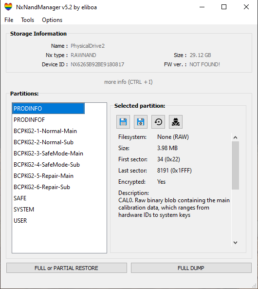

Not exactly sure which picofly version I'm using, I assume it's an aliexpress clone. The console does not have the 1-bit issue, and tegra explorer never showed any errors, except for when I tried following sthetix's unbricking level 1 guide (received a failed to backup bis error when trying to restore sysmmc). I did dump the prod.keys and opened the console in nand manager, I've never used it before, so I didn't know what to look for, the only thing that seemed out of place to me was the fact that it could not find the FW version, which I updated to 16.0.3 before installing the picofly.
