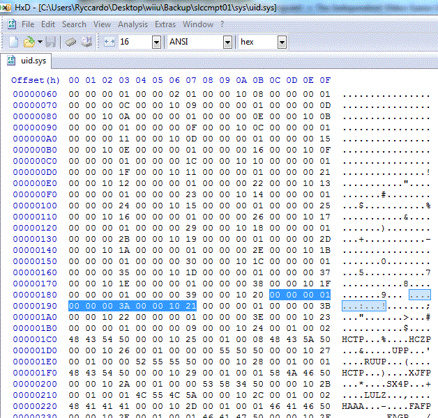

From this part in slccmpt:/sys/uid.sys we can deduce that the owner (not permissions) for ios58 is 0x1021:
(this should be same for everyone given how there are only other factory-installed system titles before, but never hurts to check on your own console) http://wiibrew.org/wiki//sys/uid.sys
