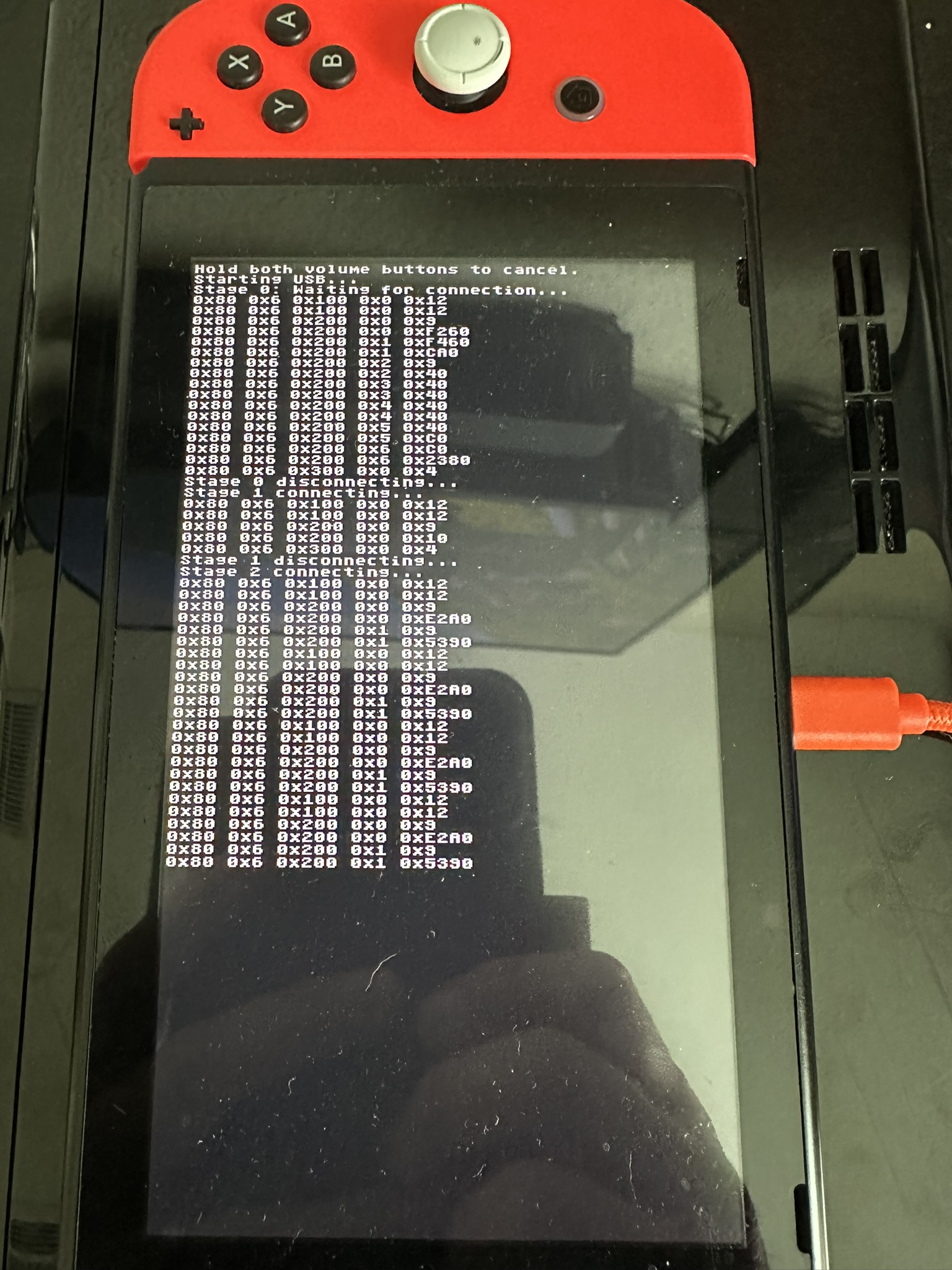

  • A Nintendo Switch capable of running udpih_nxpayload

The console update is 5.5.3 E need eruop gamepad cant go on satting but only controlled with wiiu controll the gamepad i have only one region Japan and one is usa region.. The console i have is, wup 101 (03)

Yes bro i use picofly chip that mod nintendo switch to inter my console recovery menu i use int type file that use for wiiu not display on tv and yes it is working now i use my usa gamepad on wiiu and mod wiiu aroma cfw 5.5.5E and backup full nand clean... I need plagin link👏 ❤️
