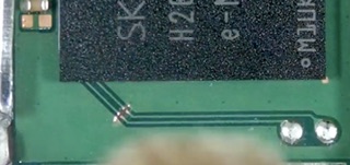

For reference, here are pics of each of the points you will have to deal with including a micro sd card for scale. If you can successfully replicate each of these joints on your practice board, then you are good to go.
For scratching the CLK trace, dont buy a grinder. You dont need mechanical assistance and a grinder makes it easier to mess up. You can just buy the needle tips for a grinder and scratch the trace by hand. It's more controlled and less likely to destroy the trace. Light pressure. You can see a good example of the tips you want here:

After you have soldered in the clk trace, you want to mask it. I use clear UV resin on a toothpick and then hit it with UV for about a minute. Don't go too heavy. You just want to be sure you arent going to rip that trace off.
I absolutely DO NOT recommend the flex pcb for the OLED ABCD points. DO use the cpu ribbon and the dat0 adapter (preferrably the gold full size dat0). The main flex cable for the rest of the points has caused more issues than you would believe.
34 AWG enameled wire works great. Hold the wire to your soldering iron until a bit of solder sticks to it so you know the tip of the wire is stripped. Pre-tin all points. Be conservative on the amount of solder on the tip of your iron, especially for the CMD and CLK points.

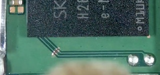

Good callout. He definitely does, but thats only important if your adapter has exposed traces on the back that could short to one of those points. If there is nothing shiny on the back of your adapter in that area, then its not something you need to worry about.
You can see here that the black adapter has much larger exposed ground pads that could impact those points. The gold one on the other hand has a much thinner profile on those exposed pads and has no real risk of shorting on those points. Sthetix's advice here is very cautionary. Its good advice but only use it if you need it. You could unintentionally do more damage cutting traces you didn't need to cut.

Thank you very much for sharing your tips, especially the pictures using the SD card for scale, I was looking on the internet for the size of that CLK point and I couldn't find anything that gave me an idea of how small it is.
I've practicing micro-soldering lately on some e-waste and I think in a few of months I might feel confident enough give it a try.
Could you please elaborate on why you do not recommend the flex cable for the ABCD points? As an amateur hobbyist I wasn't considering buying solder mask and an UV lamp, so I thought that flex cable could be an option.

The flex cable has a couple issues that I have observed. The first is that the solder pad for the clk point is substantially larger than the clk trace which can cause it to unintentionally bridge to the nearby ground pad. The difference in size also means that if the solder joint gets pulled, the solder has a better hold on the flex ribbon than the trace and it can pull up the trace. The other issue is that the ribbon doesnt sit flat. It "drapes" over several components with the 3v3 point at the top and the clk at the bottom. That curve tension isnt going to hurt the caps that the 3v3 is coming from but there aren't equally strong bonds on the opposite end to the cmd resistor and the clk trace and over time the clk trace tends to break. None of this is to say that it can't work. It just stands a good chance of causing you more issues than it is worth.
