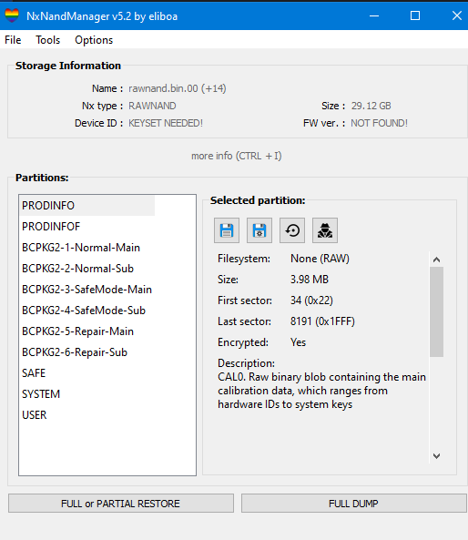

Hi there, my switch had a broken emmc chip. I replaced it, restored an old backup from 2018 (had to rename the folder tho since the replacement's NAND ID is different) but when I try to boot it using the stock option in the hekate_ipl template, it says unknown pkg1 version and hos version not supported (see the picture below for reference).
I have placed the latest hekate and atmosphere files onto the sd card.
For some reason the switch always goes to rcm mode, but autorcm is disabled in hekate, the button won't change to On, even after trying to turn it on.
So, the raw backup/restore option also backs up the prodinfo, sysinfo, boot partitions and BIS keys, right?
In theory, it should've restored these partitions as well, right?
Should I try restoring the backup again using NXNandManager?
And I should probably try to reformat the emmc with gptrestore, right?
But that still doesn't explain why it's always going into RCM mode.
Maybe the replacement mmc is broken or I have to partition it first before restoring the backup.
