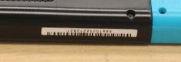

Muppet here. Recently bought this unpatched switch from a pawn shop store on ebay, at least I'm pretty sure it is. Can someone put my mind at ease? It was a good deal so I didn't study the picture as long as I should have before buying (and I was stoned). Pretty sure the first 6 numbers of the serial after the XAW1 are 005621.
When I checked with a Online Web:
👍 Your console is not patched. Hooray!
That's all the information we could know through the serial number.

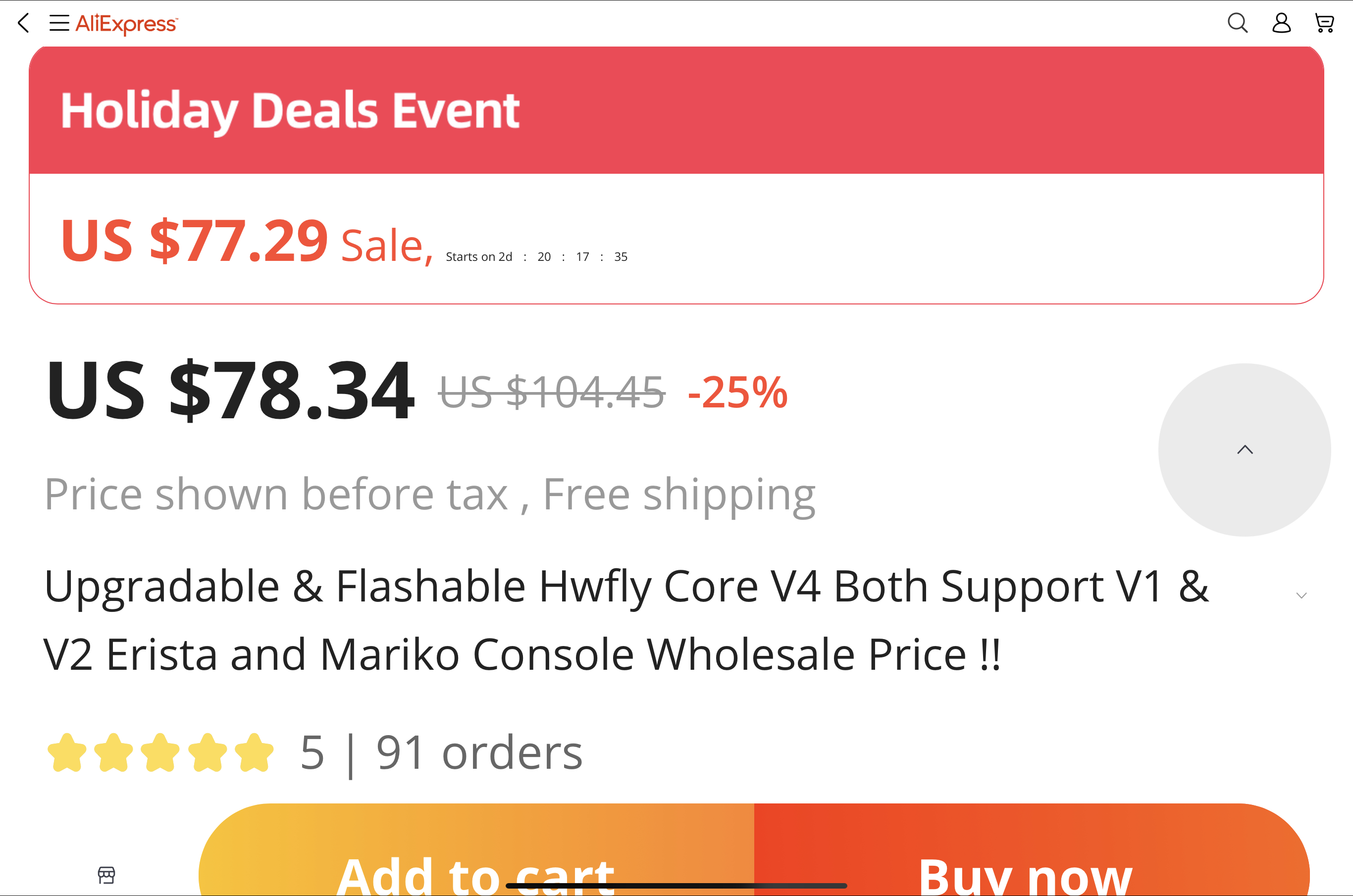

and is there a way i can mod a v2/redbox switch on 12.0 firmware ,, so this ''switch.homebrew.guide/usingcfw/manualchoiupgrade" will essentially brick the system ?

I thought V4 was just the generation of the modchip. I bought one of these for my V2 Mariko and it works great.
I wish they would have used different nomenclature….like version A, version B, version B.2, etc
Less confusing!
