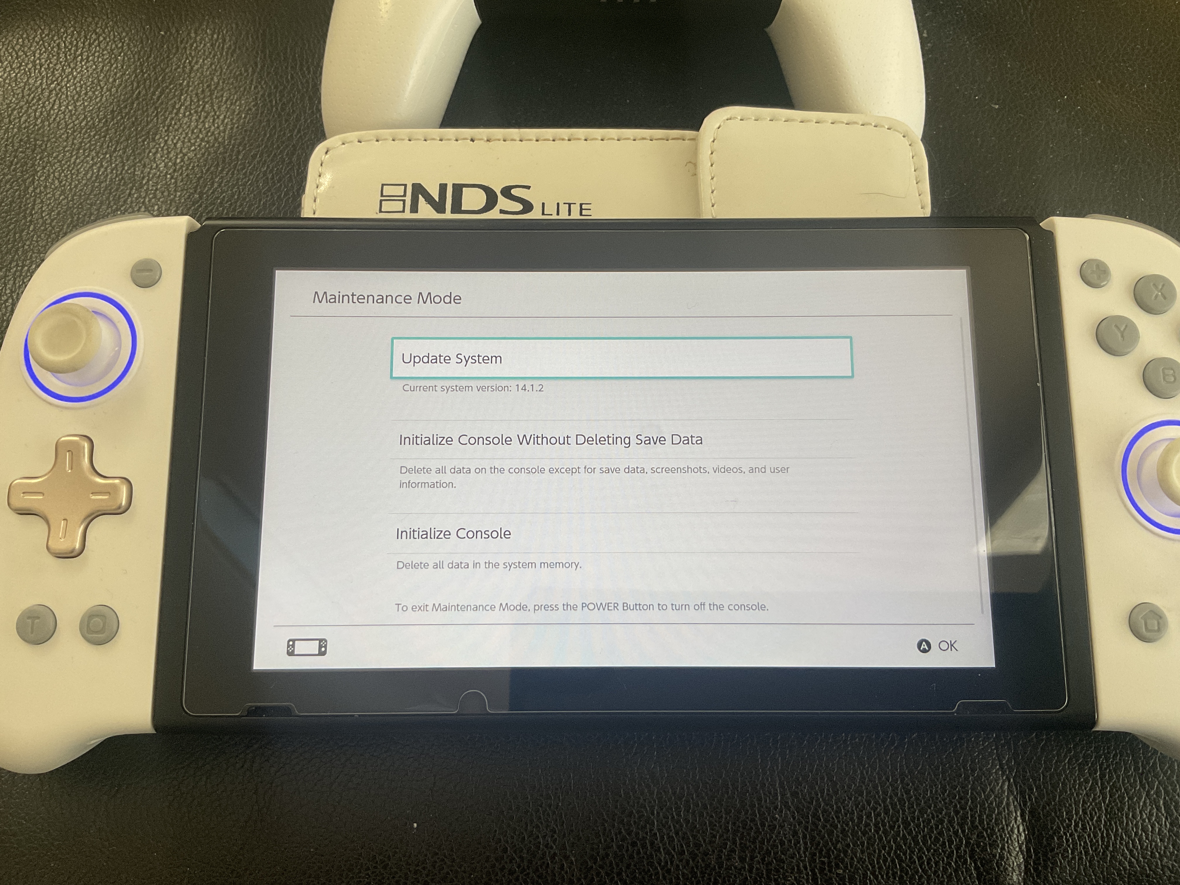

That’s not good. That means it successfully talked to Ninty. @Hayato213 is correct in the way you block it using exosphere and dns:mitm.
now that you’ve connected I believe you can reset the nag by entering into maintenance mode and restarting after steps 1 and 2 (but NOT step 3…just reboot)

It would seem I messsed up there, yes. The problem is, I can't do this because I have a modchipped Mariko Switch. Or rather, I can't take the risk. I don't understand the why and how behind it, but I was explicitely warned to NEVER press POWER and the +/- volume buttons lest I want to brick my Switch (apparantly it works differently when you use a modchip instead of a softmod).
Update: I tried exosphere out, but as I feared, it's too late already. The nag is in the system and I'm stuck because as far as I know the Mariko Switch - for whom the rules seem to be different from the regular softmodded Switch almost everyone uses - can't enter maintenance mode via POWER + volume buttons.
I have a Mariko beside me with an hwfly modchip. Going to try to enter maintenance mode and see if I brick it.
E: here goes nothing!
held +/- plus power and successfully entered maint mode on my Mariko.
E2: oh shit!
E3: Just kidding…works like a champ
e: here goes nothing!
