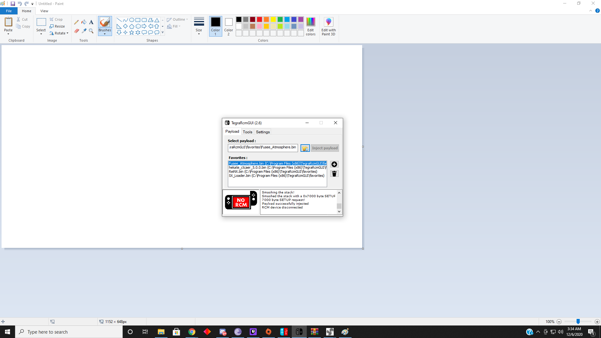

All this time I have been loading through Hekate. Im using TegraRcmGui. Ill try switching over right now.
It gives me 4 options to choose from
Is the one labeled Fusee_Atmosphere the one you talking about? Or something else entirely?

Download this and launch with this payload
I downloaded the file and injected that specific payload, and it brought up the Atmosphere word and its purple background, and some R letter beneath it (Not sure if I need to press anything there)....anyways after like 20 seconds the word Atmosphere and its purple background go away and are replaced with some black and white logo kinda looks like a triangle. And then it loads into homebrew.
However when I click on Tinfoil Installer, just like before it goes black, then 1 or 2 seconds later the homebrew screen shows up
