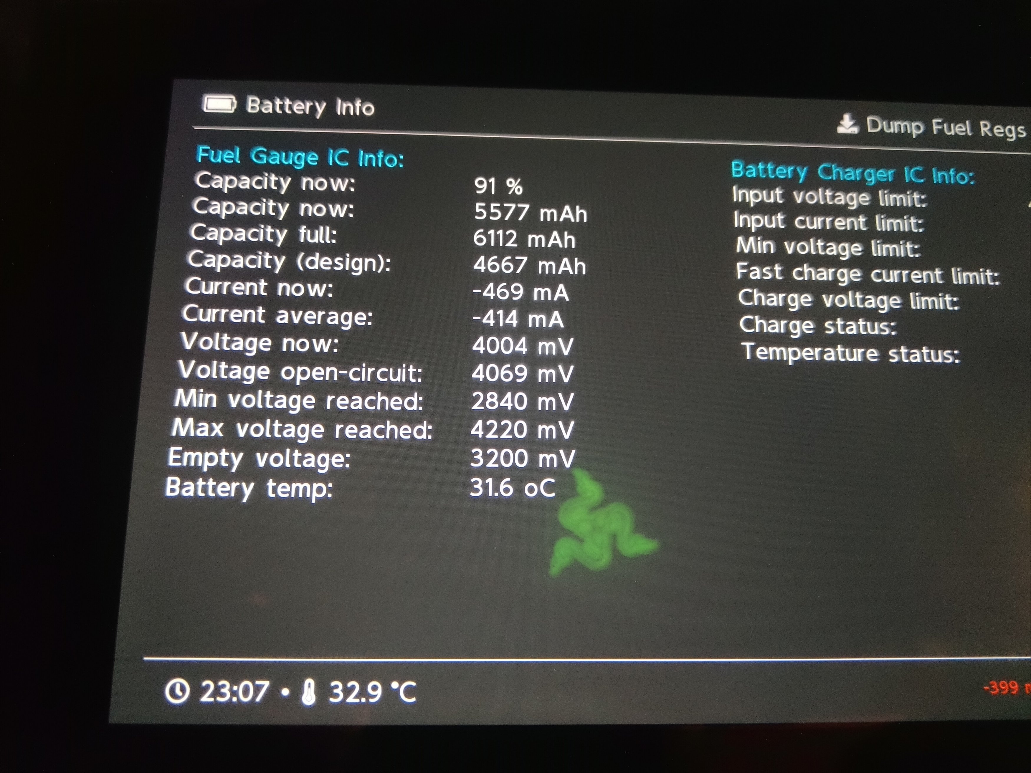

on my switch my full capacity is higher than the capacity (design)....is that normal?
