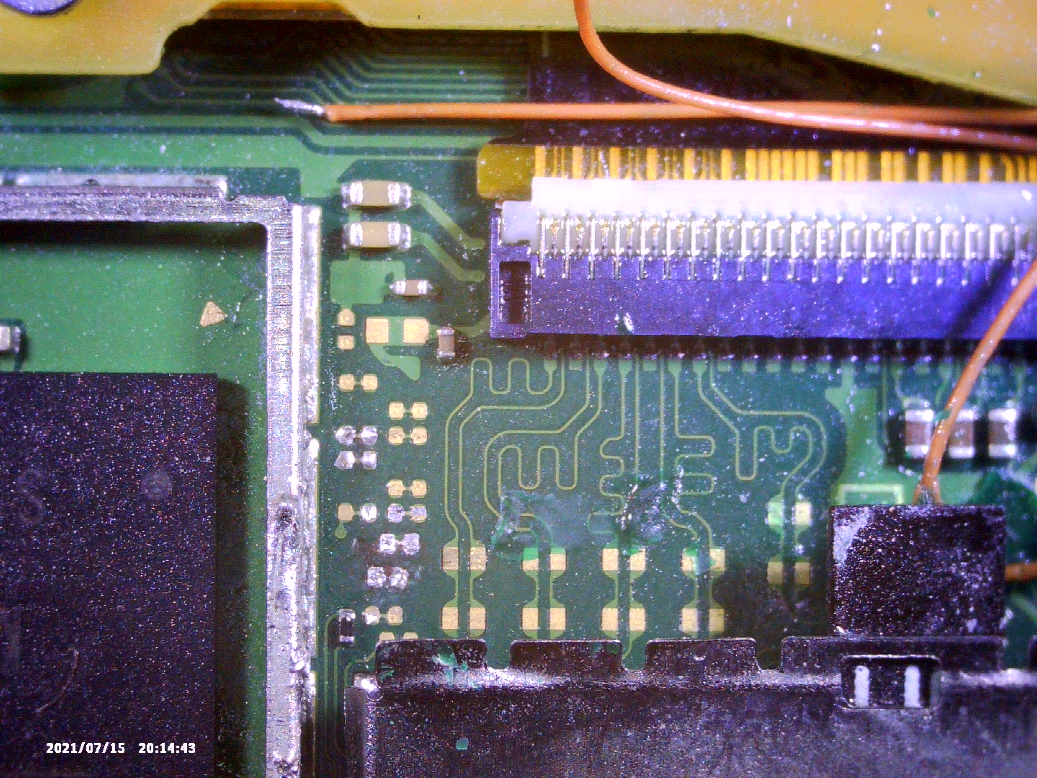

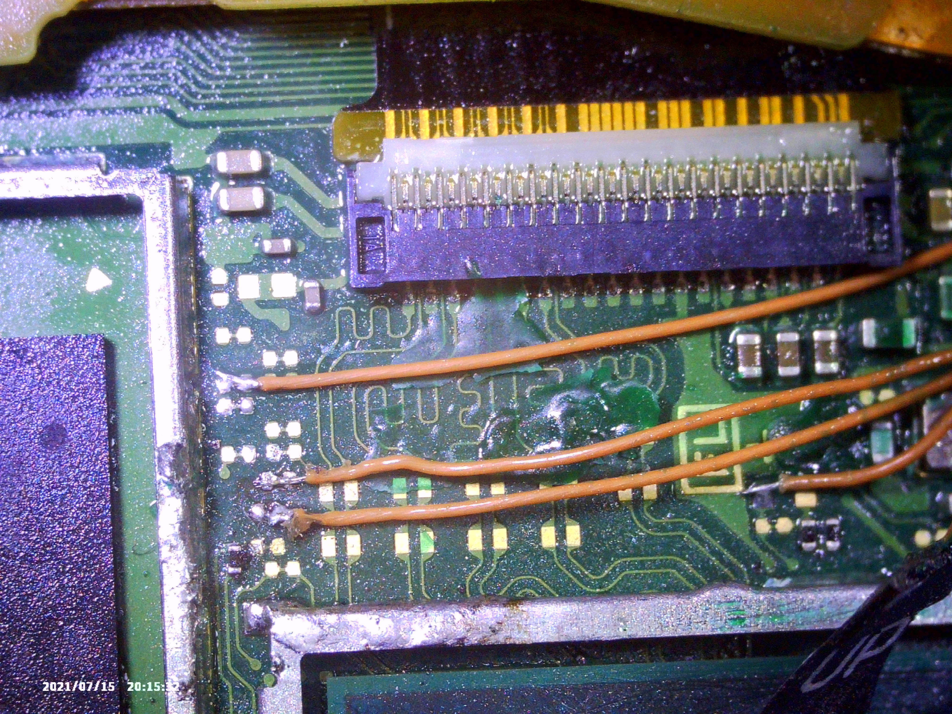

Hello all. I recently bought a bricked switch lite to see if i can fix it. The pre-owner of the switch said that the autorcm bit was set. picofly was removed by pre-owner and i installed picofly back into it to see if i can boot hekate. Picofly tries to glitch (Blue LED), after that i get this error code: short, long, long (*==). Is there a way to get the switch working again? I thougt i could remove the emmc and solder a new emmc back. If this works i will try to dump keys from it to decrypt the original emmc if possible so i can remove autorcm. Could my idea work? Any other ideas?

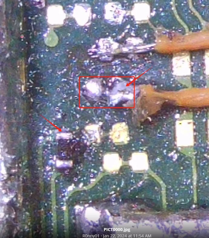

Here are the pictures u asked for. Im sure that autorcm is enabled because the switch is in APX Mode if i connect it to my pc.

clk right pad looks tricky to me, also the resistor seems not sitting on there well.
Can you remove all cable and check the pads?

Pads looks fine to me. Resistor is also okay and have contact to pads. Exept the cpu flex all cables are removed. Pads looks fine to me. Need a new battery for my multimeter -.- just died. Switch still in APX Mode.
EDIT: I replaced the emmc, still same error. APX Mode still there. Found some explanation about my error: *== No eMMC CMD1 request (poor wiring, or dead CPU)
My wiring is okay, so i guess there might be a problem with the cpu..
