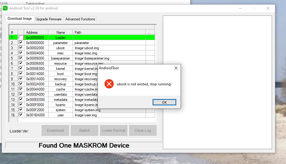

immer noch das selbe...rockusb gibt es, der mega drive wird vom adb erkannt als Maskrom Device und swich geht immer noch nicht

still the same...rockusb is available, the mega drive is recognized by the adb as a maskrom device and swich still doesn't work

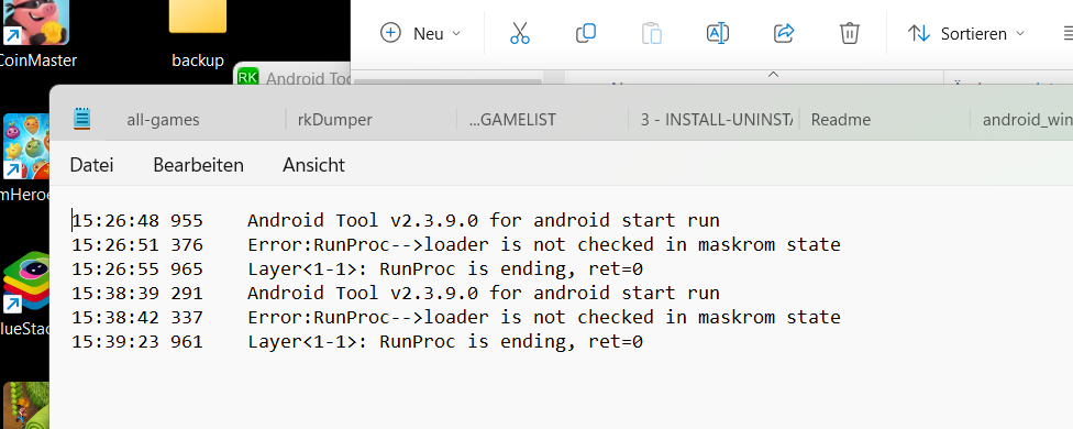

1. Please send me the last log file.
2. Also please open a command prompt then type in and press enter: adb reboot bootloader
3. Might be able to flash in DFU mode "MASKROM mode" , by pressing Download instead of Switch.
The boot Loader, which seems to be missing or currupt, is part of this flash image.
I think this will work.
Skip clicking on Switch and try Download instead.
If that doesnt work then try a different computer.

Ist leider immer noch das selbe, anderer PC, gleiches Problem, bei einem Android Tool schreibt er U Boot fehlt. Bei dem anderen der gleiche Fehler wie heute morgen...
Ich bin verzweifelt 😭

Unfortunately it's still the same, different PC, same problem, with an Android tool it writes U Boot is missing. The other one had the same error as this morning...
I'm desperate😭
Did you try pressing the Download button while in MASKROM mode?
(Skip the Switch button step.)

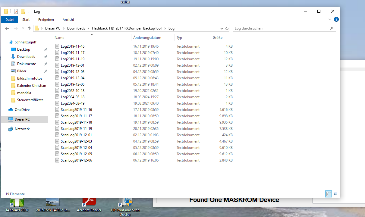

Please send screen captures
and the log files from the Flashback_HD_2017_RKDumper_BackupTool Log folder.

Ja ich habe beide probiert, bei beiden Match device Type failed

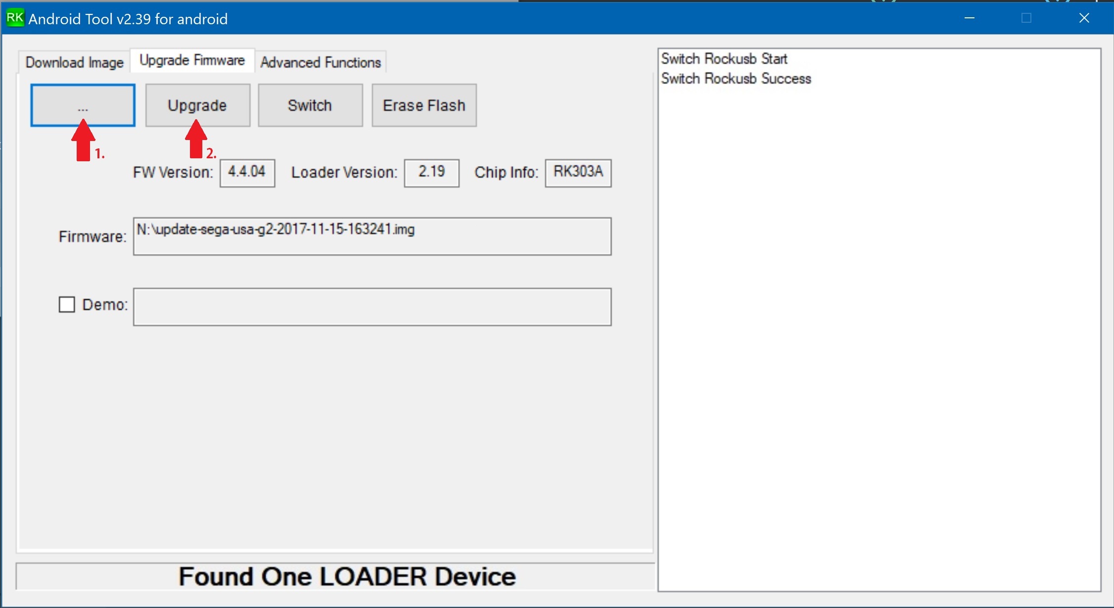

Please try this:
Flashback 2017 HD System Update
ATGames official Firmware Update for the Flashback 2017 HD.
https://mega.nz/file/DgB0GLSL#ndlyWh5lIPAx9VXwX64fWT6SmCa_Ixro2bRFxvOrZm8
This is an official Update to the original system firmware and not a full backup or restore.
Same backup and recovery tool but the process is a little different.
Connect to the console with the tool and then click on the Upgrade Firmware tab.
1. Load the img
2. Upgrade the Flashback 2017 HD firmware.
https://i.postimg.cc/FFYWkDf4/Update4.jpg

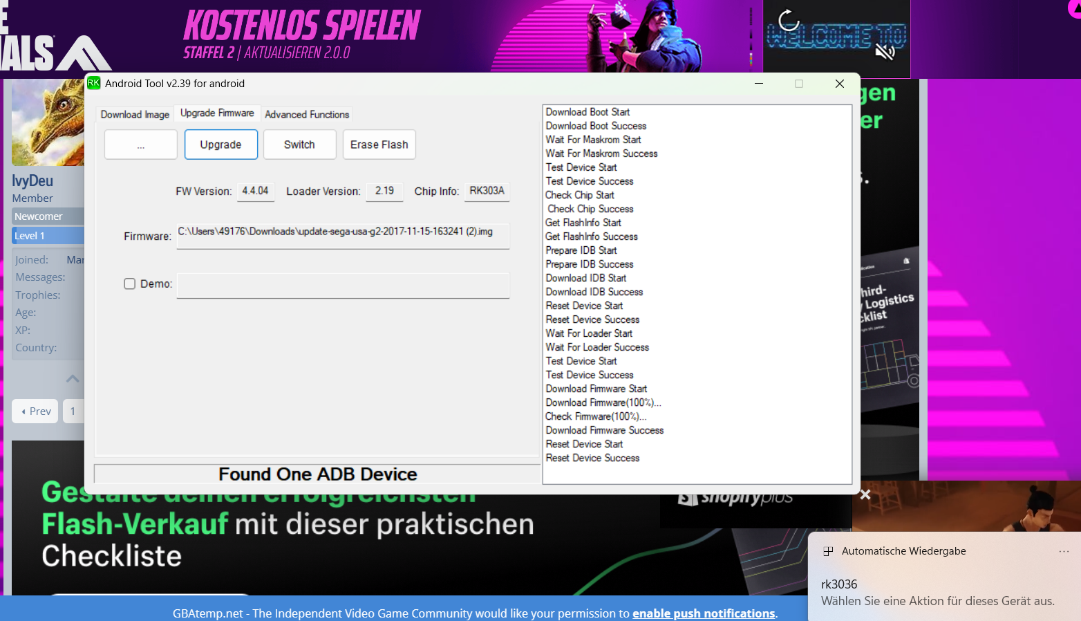

YES ist works.....
And now???
erst switch dann download....
YOU ARE MY HERO!!!!!!
so sieht der NAND ordner jetzt aus, ich glaub genauso wie ganz am Anfang

YES ist works.....
And now???
first switch then download...
Great news!
The hero is actuallly GBATemp legend: rrifonas
We worked together on this console and he explained that the loader is included in the update image
and because of this the update should work through MASKROM mode.
You are welcome!

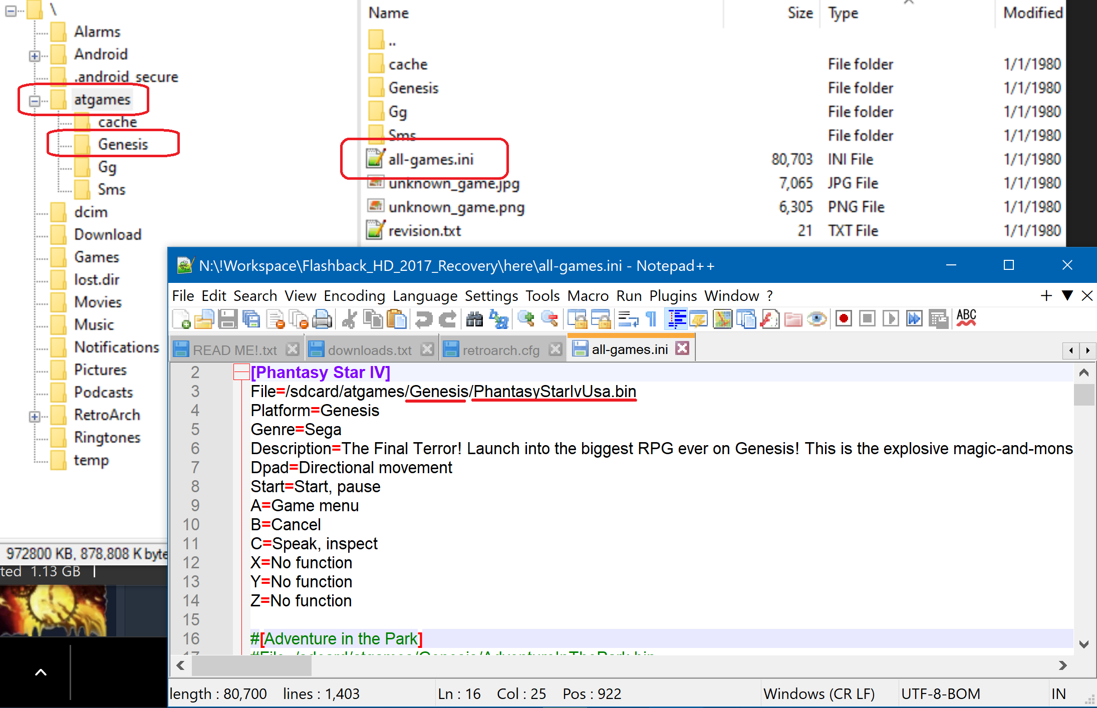

https://gbatemp.net/threads/sega-me...nal-mother-board.491498/page-44#post-10038694
Connect the console using USB and access the file directory.
Find the all-games.ini and make a backup.
To add a game copy and paste the entire entry shown here and then edit it with the new game information.
Do not use spaces in the file name and caps are important.
Put the game in the proper directory.

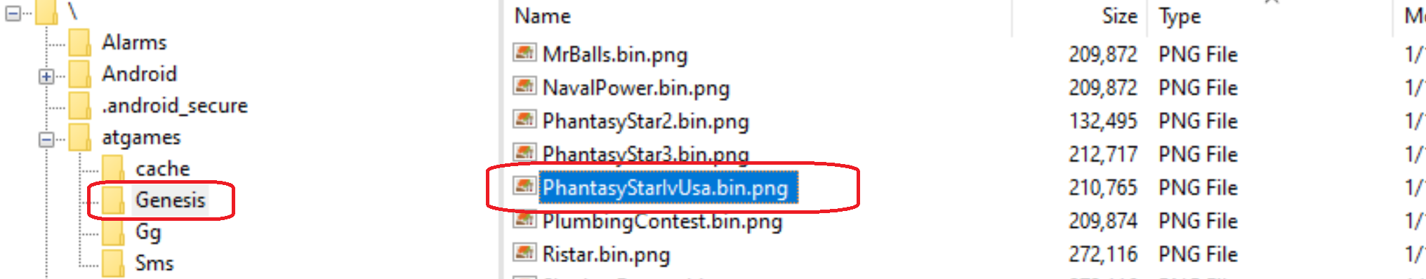

You'll need to add an icon/picture or you'll get a blank.
Use the exact same name and png picture file format as the new game.
To create a new picture, make a copy of an existing .png and paste the new image into it.
Then rename the picture using the exact same name as the .bin file.
Use the naming format below.
