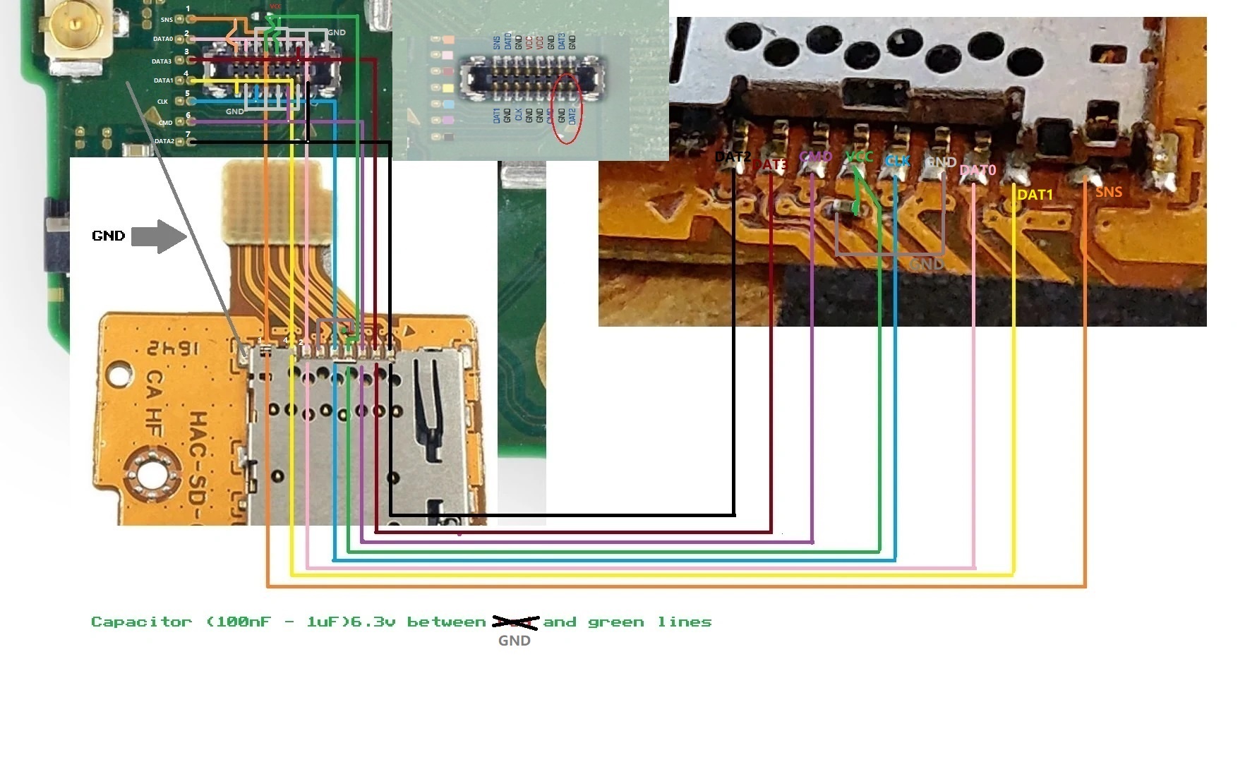

jkyoho
Sep 2, 2020
1,280
39
TORONTO
form.jotform.com
2,210
Here is reference pin mapping for the connector incase you need to see which pin got broken connection
