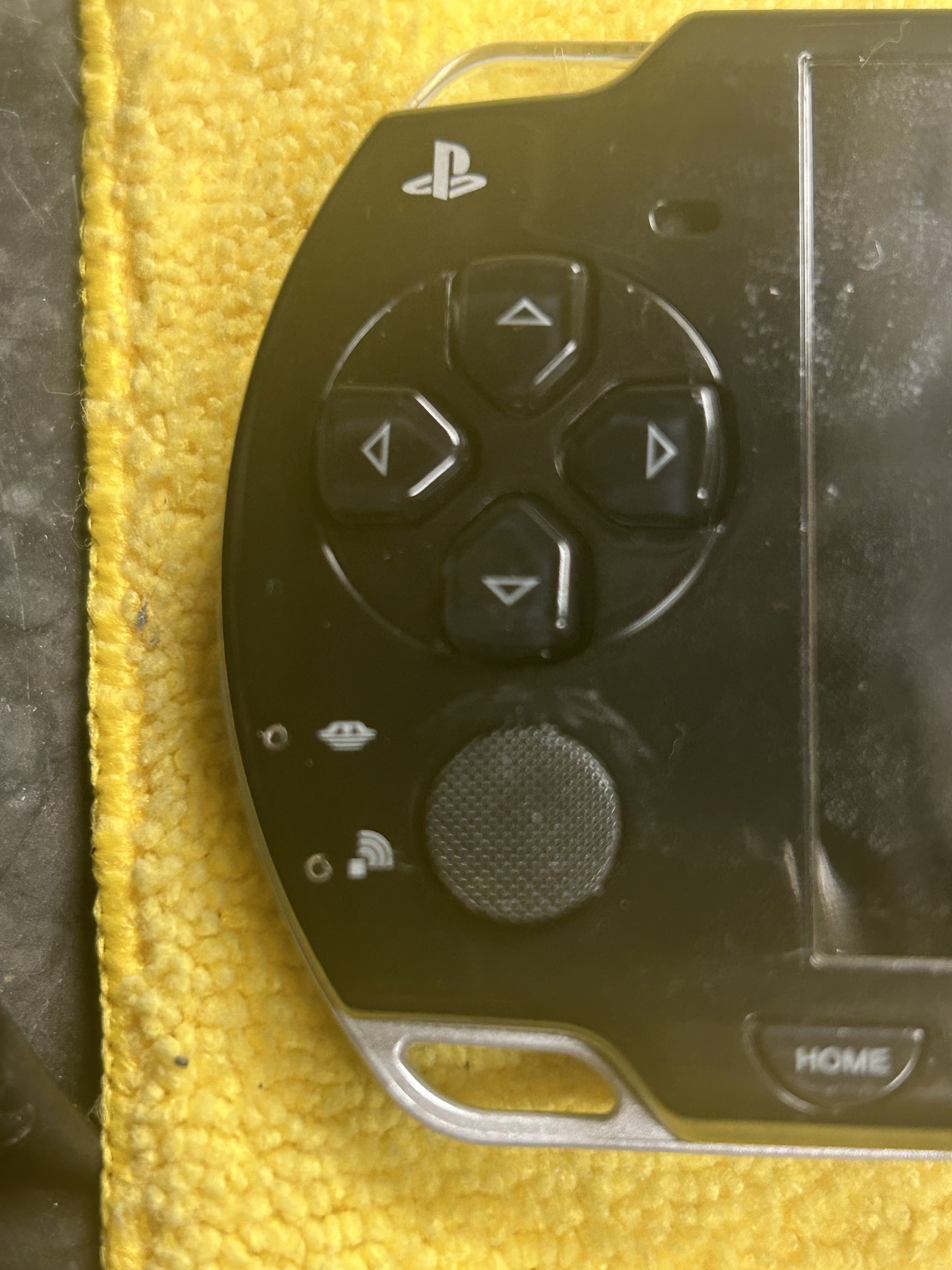

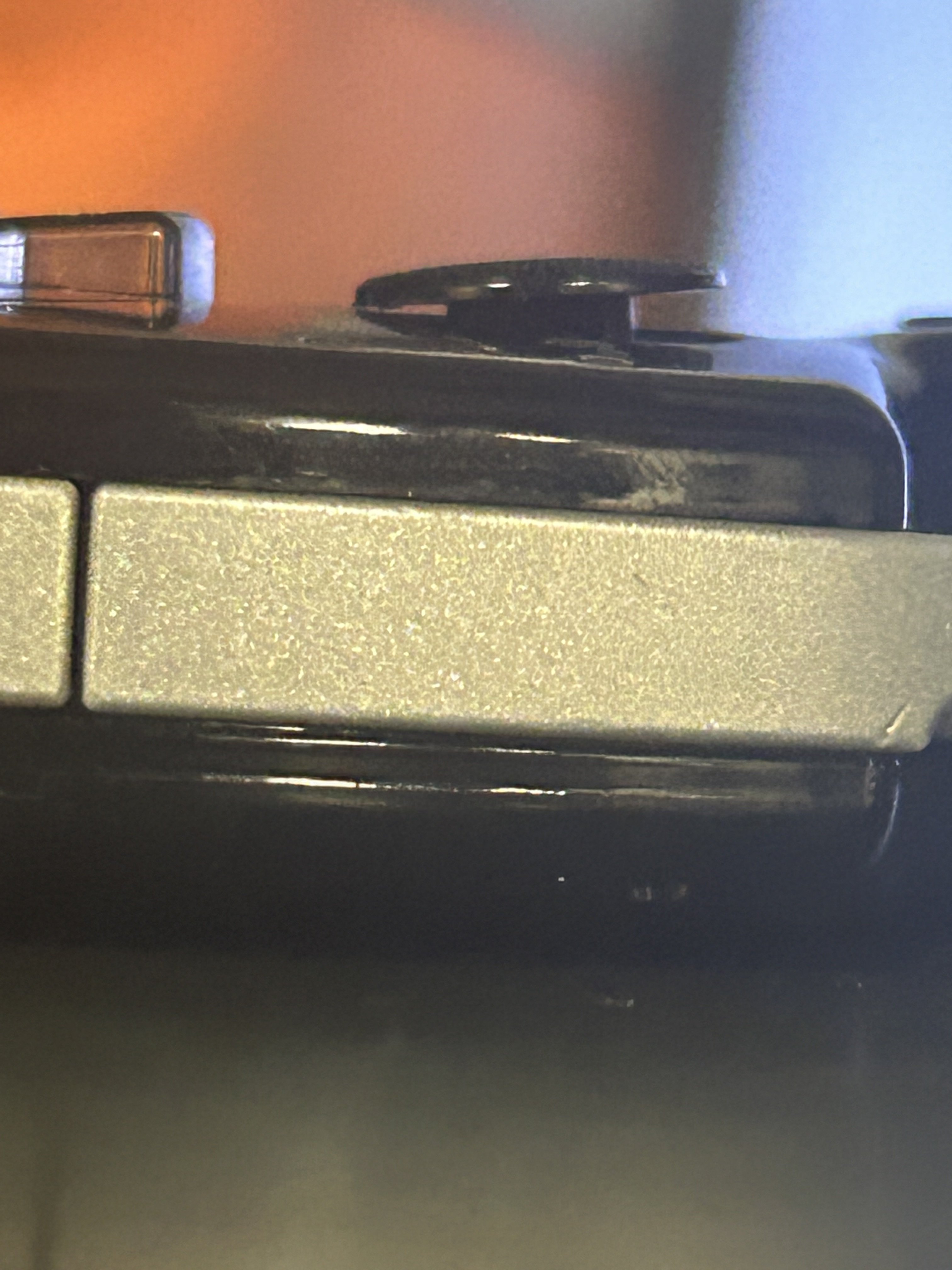

I didn't find much information about this online, so I figured I'd ask here. Right now I have a friend's PSP 2000 which I'm in the process of unbricking using BaryonSweeper. I opened up the system and did cleaning and I noticed after the cleaning just how wobbly the nub (not sure if there's a better name) is. It can tilt to the point that it touches the face of the console, as evidenced by the scuffs around the nub. It can also be pulled up slightly. I compared this to my PSP 3000 since I thought it was odd, and my 3000's nub is fairly tight and doesn't exhibit those characteristics. I've attached a couple of pictures to better show what I'm talking about.
Is this something that is normal with 2000s, or is something wrong that can be fixed?

I would think the 3000 is how it's supposed to be since it's not rubbing against the face and causing scuffs. It's possible that's how the 1000s and 2000s were designed and it got "fixed" with the 3000s, but that would be a pretty big design overlook.

I can see from the pictures above the joystick's actually touching the top of the shell. That can only mean the joystick either isn't screwed in properly or it's some new shorter nub? No idea. I will also recommend getting a new top shell and a glass screen because it's crystal clear and there's no matte plastic and I love it. Used B7000 glue like I saw on youtube and it's incredibly strong. No worries at all about the screen giving in.
Oh, I can also see on the top picture the joystick is tilted at an angle. There's a chance it's come loose inside the shell so you're pushing it onto the top shell.
