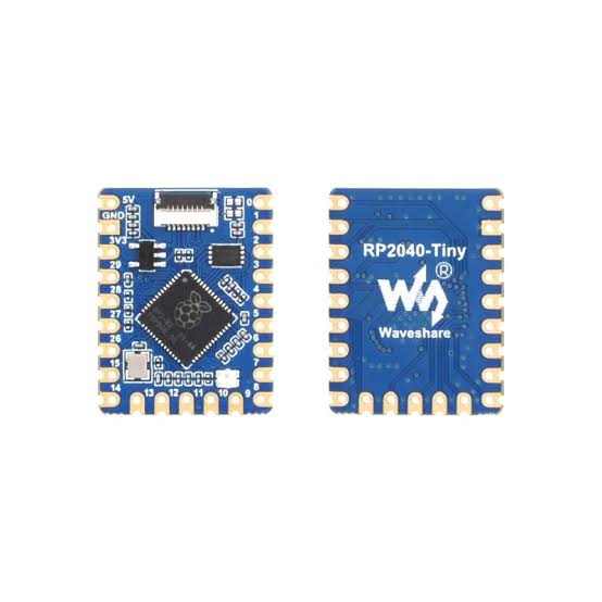

Can anyone tell me if the capacitors in the flex cable has to do with boot time because my ship boot different every time I turn the console off and on
Wich capacitors can be swapped to the CPU from rp2040 tiny?
I messed the 2 capacitors on CPU can someone help me to find them in the rp2040 tiny to swap them the switch is for a client and he can't wait
Look this:
https://ibb.co/2d4K7Hh
Reactions: freso
I presume you have some HWfly flex cable.
According to this post, there aren't any capacitors on the flex cable, only resistors.
https://gbatemp.net/threads/hwfly-lite-cable-components.626438/
The resistors are only on the rp2040 board. Look through this topic for the appropriate value for your Switch because some values give better results than others.
Reactions: freso

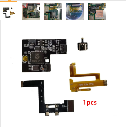

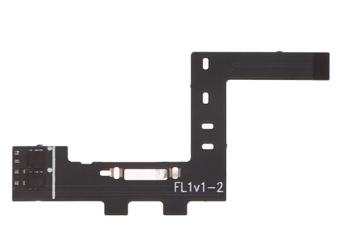

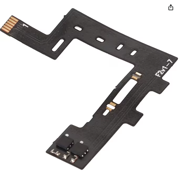

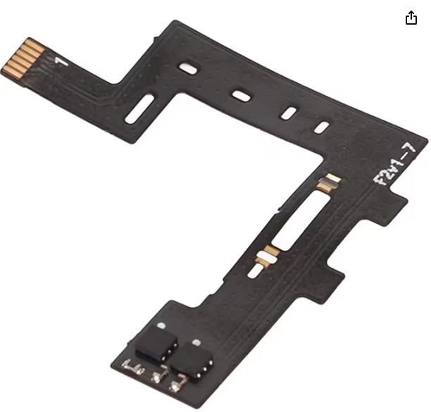

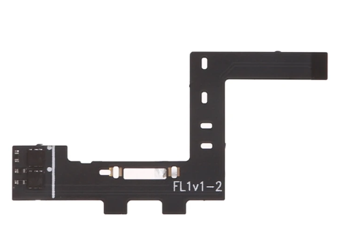

Wondering if someone can answer a question about the RP2040 switch lite flex cable. So I ordered the above from AliExpress and messed up the install of the black flex cable shown above (The yellow is fine). I couldn't get the points to solder to the resistors.
I need to order a replacement black flex and I have two options.
Number 1: The original identical flex cable from AliExpress (3 weeks Deliver). FL1v1-2 matches what came originally in pic 1.
Number 2: From Amazon (2 days delivery):
What confuses me are the different version numbers on each cable (FL1v102 vs F2v1-7). Are they the same and just a different rev or completely different?
Can anyone advise please? :)
CLEARLY F2v1-7 is for v2 not for LITE, just look at the orientation of the output gold fingers.
whatever label printing on the flex does not matter, its the shape/style defines what model(v1/v2/lite/OLED) they are compatible for custom(hwfly style) modchip

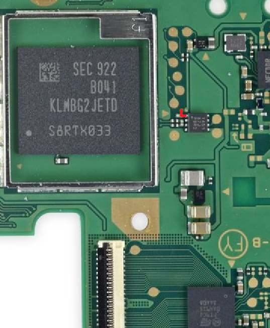

Hi, if I'm working on a Switch Lite and I want to place the rp2040 on top of the emmc shield, are there any optimal and closer 3.3v and gnd points that I can source from?
pin1cap of the thermal sensor chip in red mark
