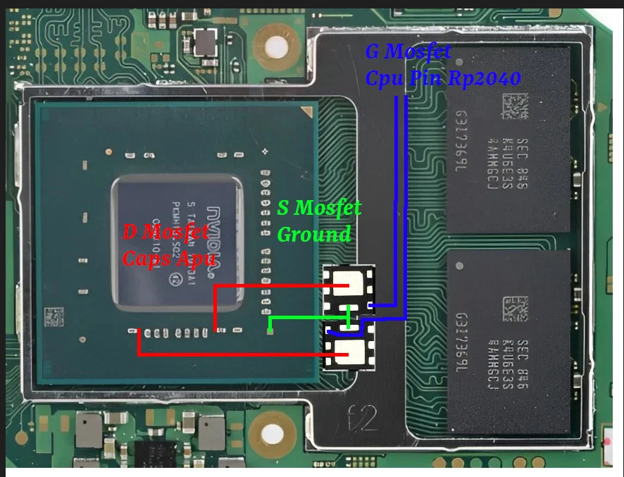

Dudes, a Question:
This diagram with 2 mosfets for NIntendo OLED and Lite are correct?
The only thing different I did was ground it on the metal and not the processor.
In the same week 2 switchs are with No eMMC block 0 read error, *=*

Dudes, a Question:
Attached a video. Any tips about it?
