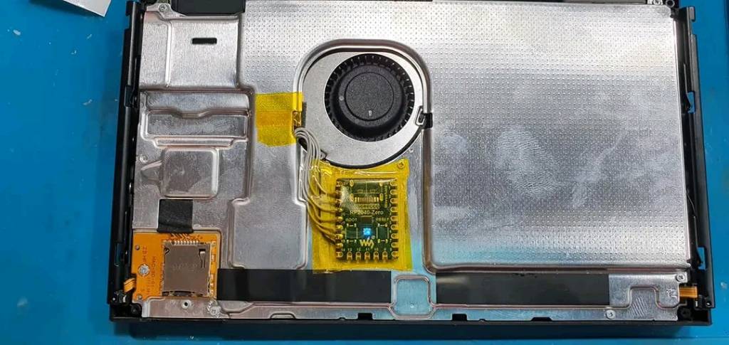

Guys what are tour opinión abouth this install View attachment 376963
Enviado desde mi Redmi Note 8 mediante Tapatalk
its beaitiful!

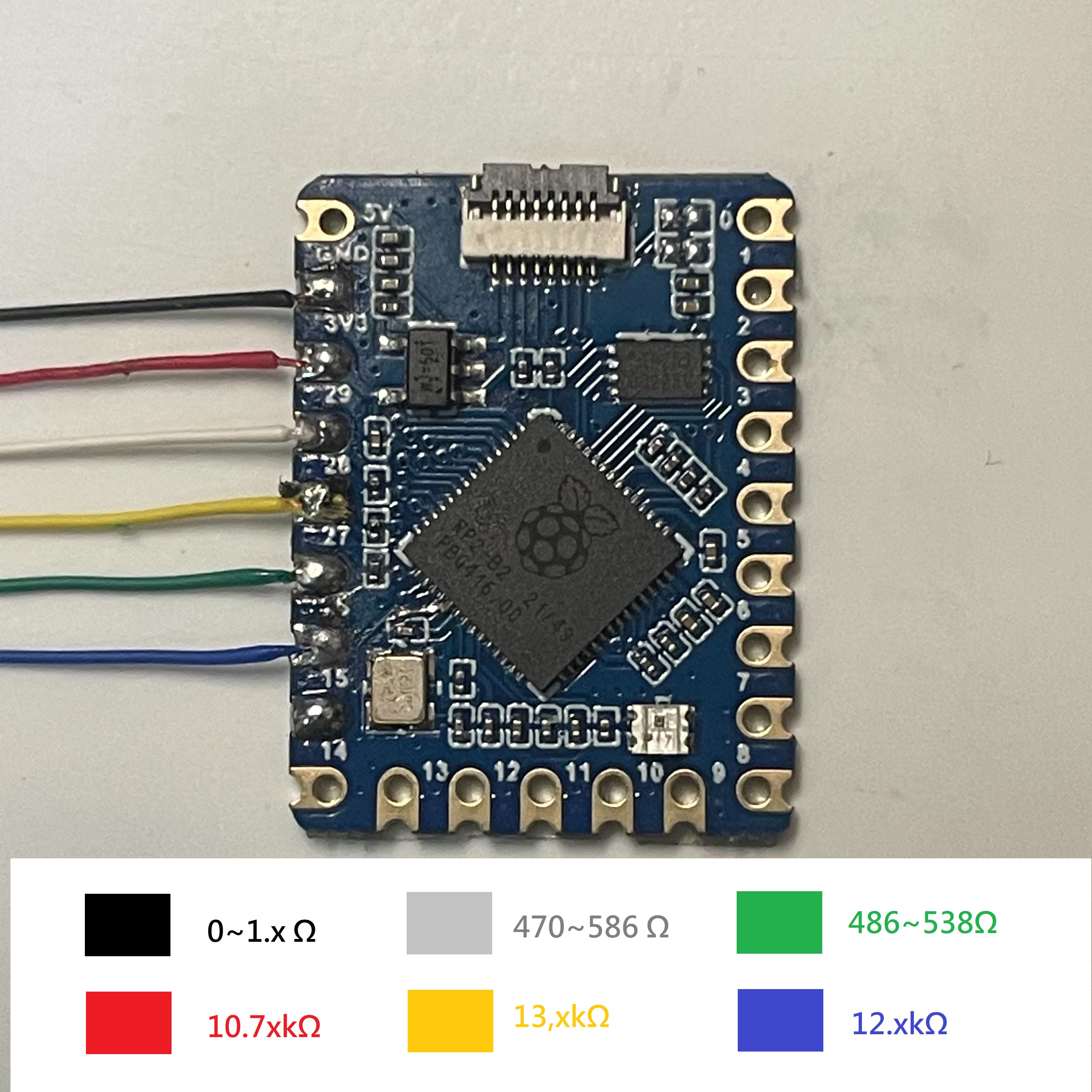

I disconnected and reconnected the battery and now I get:
=*= CPU never reach BCT check, should not happen
Please confirm the resistance value of each point
Each model is different Approximate range

Its your cmd resistor i bet eather its not connected properly or it doesnt have the correct calue anymore
Yep, my research pointed to the same conclusion. 'CMD resistor - 4.7k 0201'
Check in resistance mode for that value but more than likely its blown so get that replaced (most likely).
Good point, @Makc16384 did you use single or double mosfet and did you have a pull down resistor on your mosfet build!? Because you could potentially replace the resistor and fix the issue but a month down the line, the pink screen could return. Can you show us a picture of what your APU looks like under the hood (metal shield) and your mosfet build.
Another point, did you kapton tape/solder mask your solder joints your pico when you finished the install. I mean all around the points of the pico that were not used because they could cause shorts with the metal shielding above and below too.
Guys, you were right. From this purple screen, the replacement of the CMD resistor 4.7k 0201 helped! Thank you very much.

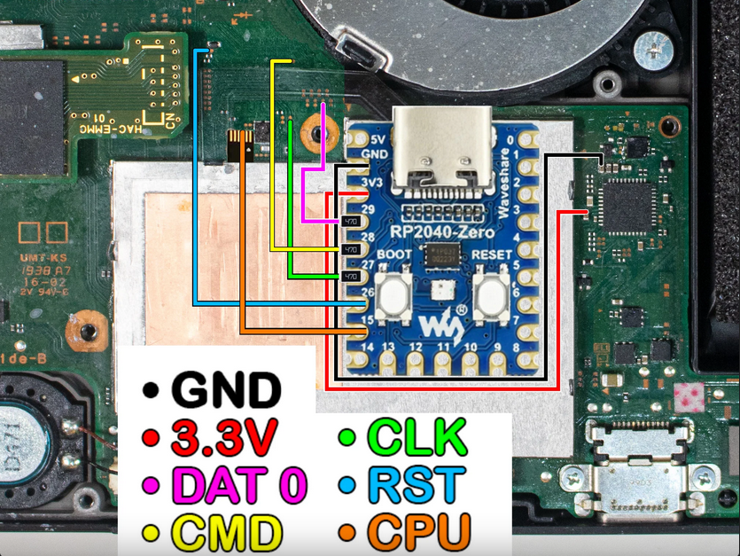

Im now mod v2 nintendo switch. I need the point in emm chip or on motherbord Mariko v2... Only i see pic that the he not bridge 2 point only use one dot //cmd. Rst. Dat0. Clk. The multimeter read same value. The digram on pic is use one point this is old digram.
