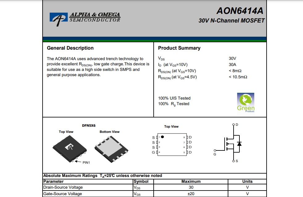

use mosfet or apu ribbon cable?
can i use this n-channel mosfet for apu?
