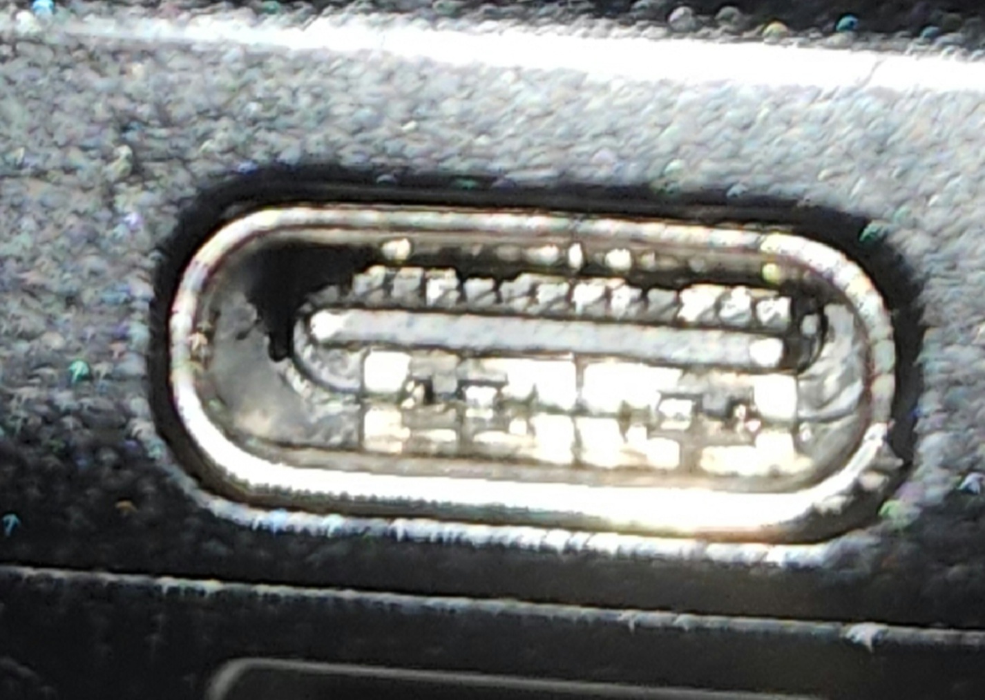

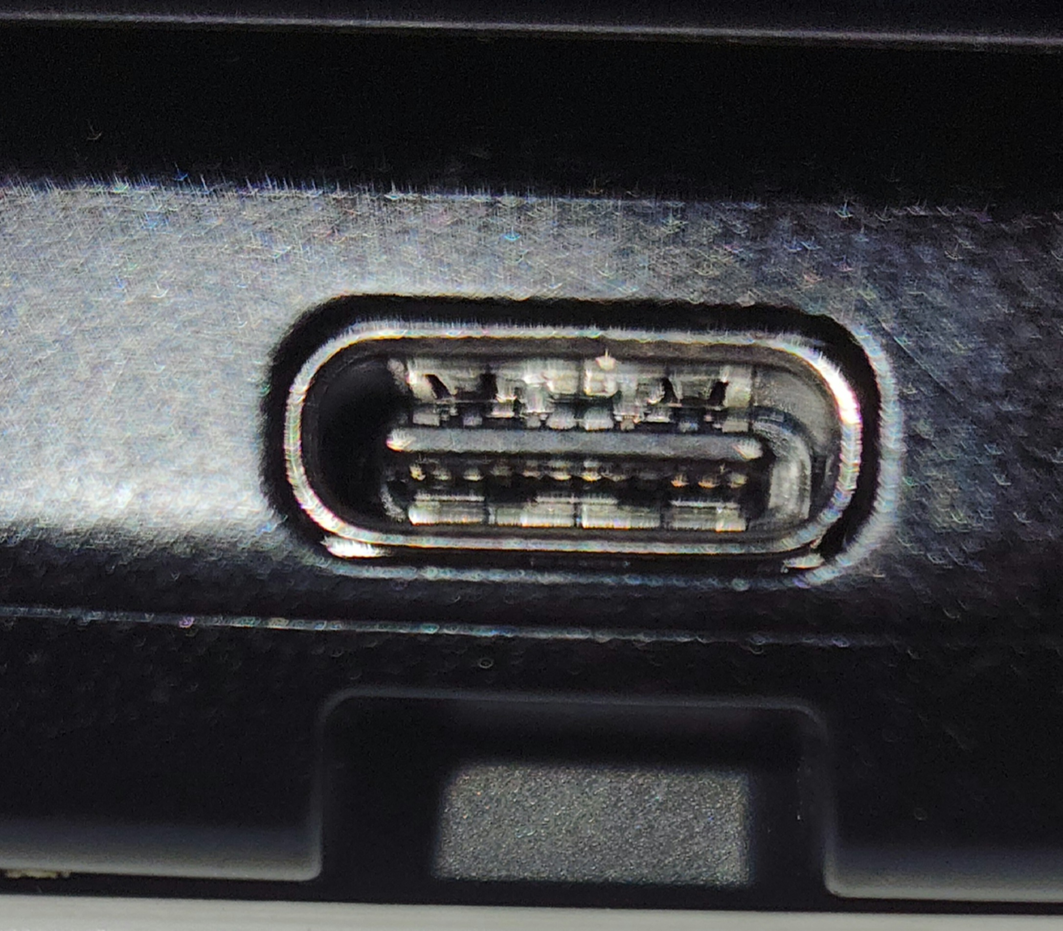

Do I have to open the console up to see those pins? I cannot see anything wrong with just seeing them up close. Not sure if the pictures are helpful.

There does seem something off at the bottom, I'm not sure if that is normal or not? Sorry I'm not very good with hardware stuff.
Here are a few more shots I was able to take. Surprisingly it is quite difficult to take pictures of such a small port up close with a phone camera.
