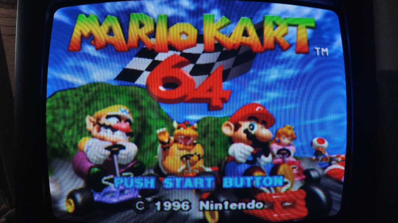

Hi xdmg01!
Thank you for your help about the OoT. It seems like you figured it out from the source code but, can we apply this method to other VC games? Like Mario Kart 64?

Yes, it works with romhacks too if they use the same 00000001.app.
For MM NTSC-U you need to extract the 00000001.app with wwcxtool. The adresses are 9E280 and A1164. Values are the same as OOT.
When you force PAL60 in these games, the game uses PAL50 video mode instead of PAL60. Still, even after patching and using EuRGB60 the video timings are totally incorrect for some reason. Probably fixable but it is easier to force RGB output using NTSC video mode.
Basically, you search for VI retrace handler function in the dol executable and change the VISetFilter4EURGB60 parameter to 1. This way the game will always enable the RGB output filter no matter what video mode you use.
Then you find the VISetYUVSEL function and change the VdacFlagRegion from 0 to 2. This will enable PAL color encoding instead of using NTSC color encoding, so composite should be PAL60 too.
This should work with all WiiVC games that have this problem.
Also, how did you actually get the source code of the Nintendo VC's internal emulator?
