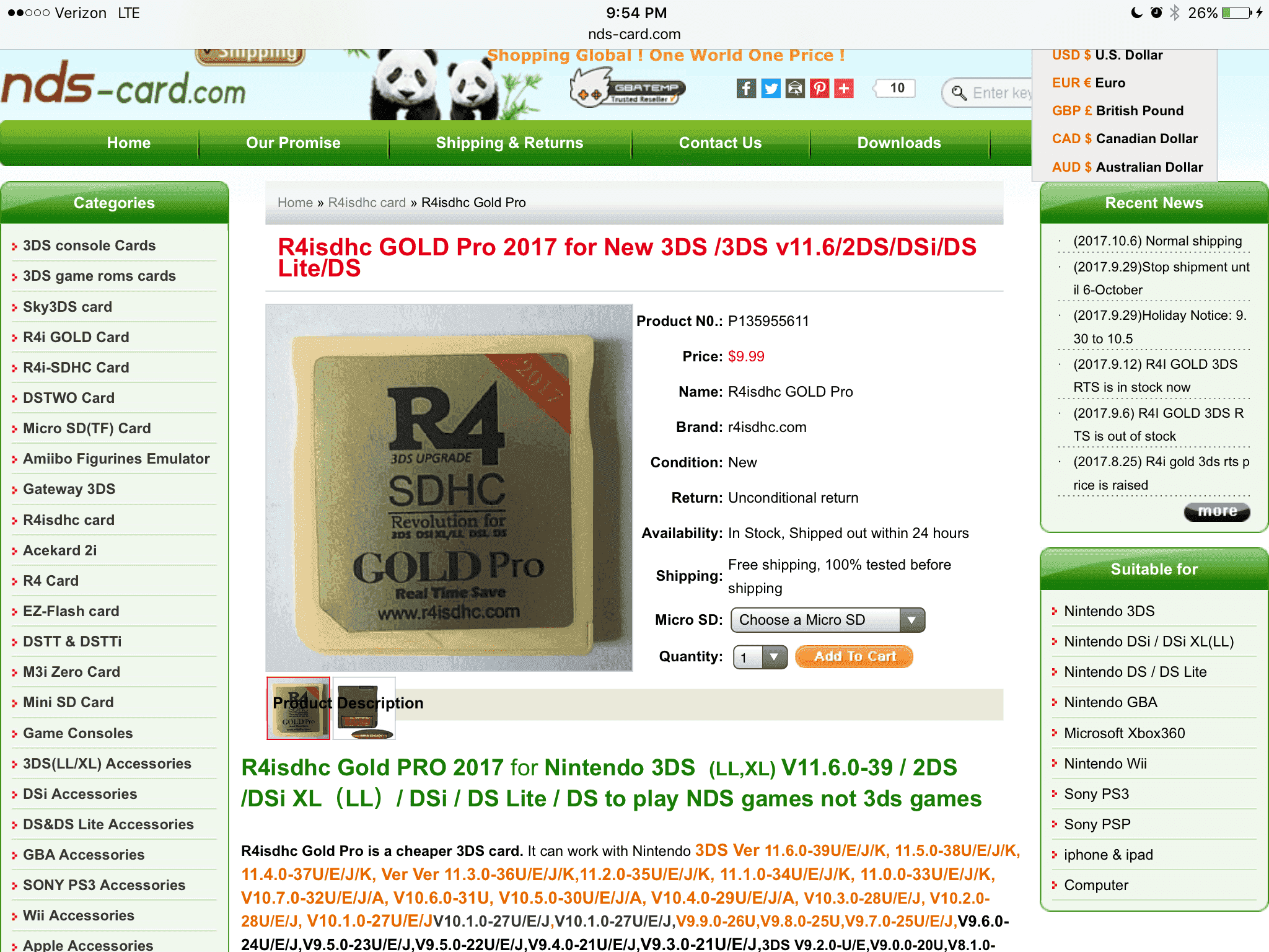

will this card work by any chance
EYY -EEE. scale em down a bit and remove the redundant ones, but hmmm .
you might be confusing it with http://www.nds-card.com/ProShow.asp?ProID=149 unless the guide hasnt been updated for new cards, the No that card is not compatible.
but all compatible cards got thier prices jacked Because of ntrboothax, and new cards announced prices seem to change within 48hrs. the AK2i was pretty cheap before this (mostly because while it had no incompatibilities, but required CFW if you wernt on an really old 3DS FW/ DSi 1.4)
