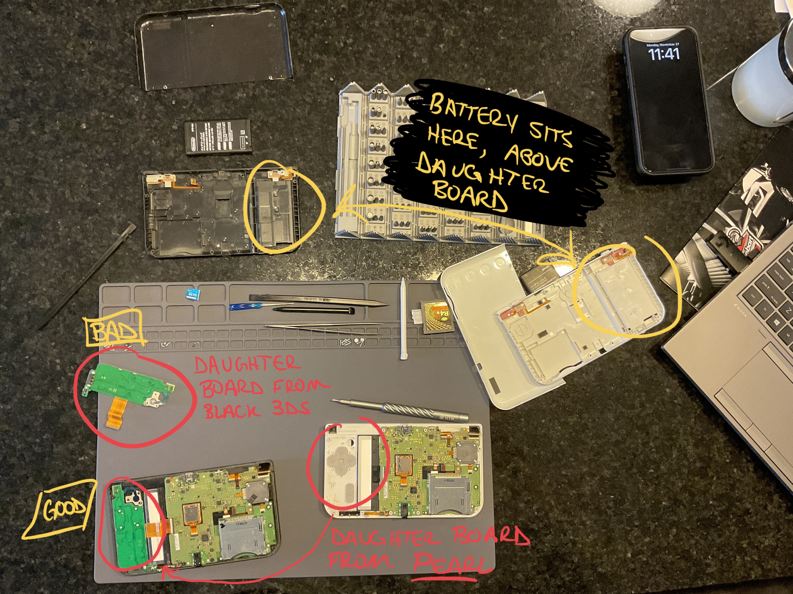

UPDATE:
For anyone who finds this thread and has a similar issue...
It occurred to me that the daughter board (the board that sits between the ABXY buttons and the battery) might be the problem because it is the board that connects the battery to the entire system. It is also called the battery board, the ABXY board, stuff like that in case you have to purchase a new one.
I swapped in the daughter board from my functioning Pearl N3DS LL and the aforementioned non-functioning Black N3DS LL started right up. It appears this is the problem, though I was only able to determine that because I'm lucky enough to have two N3DS.
I've ordered a used board from AliExpress for $11.50 USD and I'll update this post when that arrives and I install it.
See my image below for visuals.
