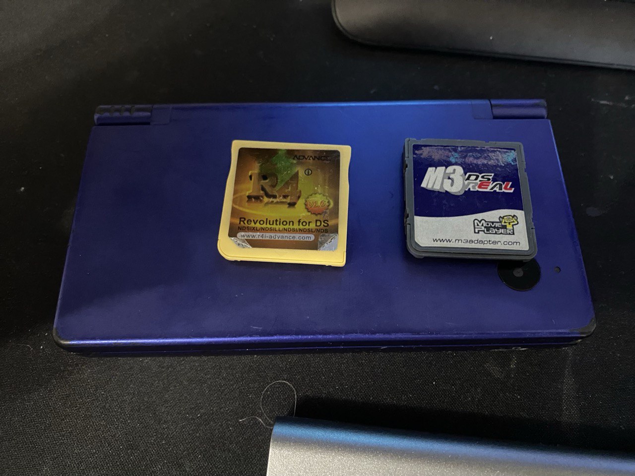

I've just got these two very old flash carts without SD and I'm trying to make them work again. I tried both to a stock DSlite (not the DSi you may see in the photo obiously :D)
- R4 v1.4 (a clone, I guess) with Wood R4 firmware > always an hopeless, white screens of death
- M3 DS Real with official kernel (this looks a genuine one), it boots perfectly but freezes when i try to launch a random game, just after the "create save data" screen.
SD is a freshg FAT32 one.
How can I try to debug and to have at least one of those working?

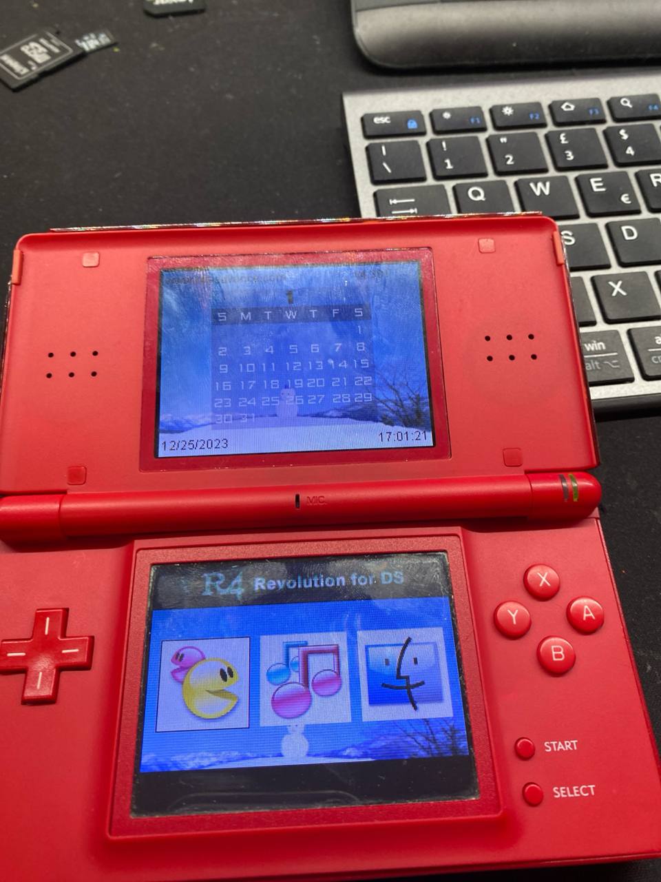

Well...I was able to solve half of the issues :) R4 works now, it was just to find the right kernel for that particular clone cart from flashcart archive.
Switching on the M3DS Real now, then I'll try to make GBArunner working

As for your R4 try and use a build of WoodR4 on it. The one you are showing above is the really old outdated original loader and you won't see good compatibility with that one as it's really out of date last I checked. As with the M3 I'd recommend making sure the MicroSD card is formatted to FAT16.
