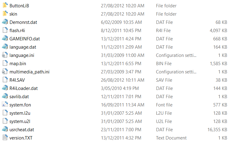

Managed to recover some files from it I believe, no sign of games that I can make sense of. I'll include screenshots of what I've found and saved to my pc.
First section
I'd be more encouraged by this if I understood any of it lol, but it does look promising, I think?
ButtonLiB and skin aren't included because they just appear to be cosmetics used by the cart. As you can see I tried looking at the DAT files that seemed promising, but it was all gibberish (probably could be read by the programs?)
I'd try formatting the card and plopping all these on it and seeing what my DS makes of it but I'd rather get some confirmation that's the best course of action (I don't want to damage the files further, or god forbid my DS...)

DS should be fine. Do not write a thing to the SD card (sorry, should have made that very clear) as it could overwrite some hidden data from it -- most deleted files are left rather than having to blank them out, and if you change the file system we don't even have that route.
Most of that looks like you extracted whatever kernel that flash cart used however long ago, and a cheat database from 2011.
I was hoping either the DS files would be noted (though sometimes recovery programs look for the files they know) or their corresponding save files (and there is a .sav in that screenshot).
I don't think anything there would act as a database for your specific files. Though I am curious what the r4i.sav is. 38kb is very small for a DS save (most will be 256 and up) but more than enough for a text list of things it ran last, not to mention the date on it is rather later than other things. Seems you can do attachments on your account so by all means zip it and share.
Alternatively all I would likely be doing when I look at it is opening it in a hex editor and seeing what is on the text window.
