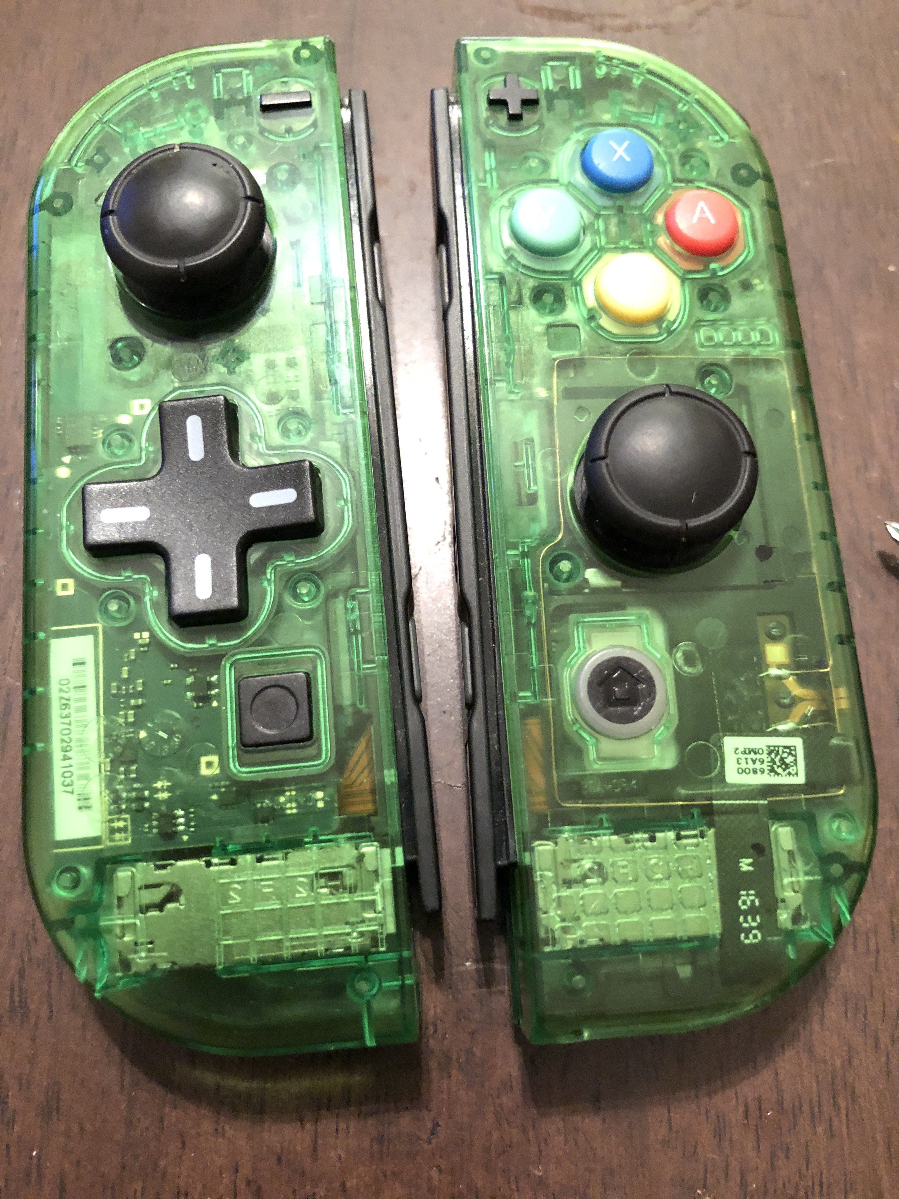

Hey guys so I’ve successfully (kind of) switched out the guts of my out of warranty grey joy cons into shiny new Transprent Jungle Green shells. Thing is now I can’t get my left joy con to sync at all.
I tried disconnecting all controllers via software and now it won’t sync back up. I’ve tried docked, undocked, reset all controller setups and nothing. Tried hooking up to my phone via Bluetooth and it does not show up.
Did I mess up the Bluetooth module? How can I fix it? Help plz

Is the green light strobing up and down when you detach it? I had this problem, it would only work in handheld mode and wasn't charging. Turned out the battery connector wasn't seated correctly, after lifting that back up and notching it back into place charging and wireless worked again. I did the ice blue ones!

@BelmontSlayer it worked in handheld mode but it does not recognize that it’s docked. So then I deleted all connected controllers and now won’t sync back up at all. I will open it back up and recheck all connections.

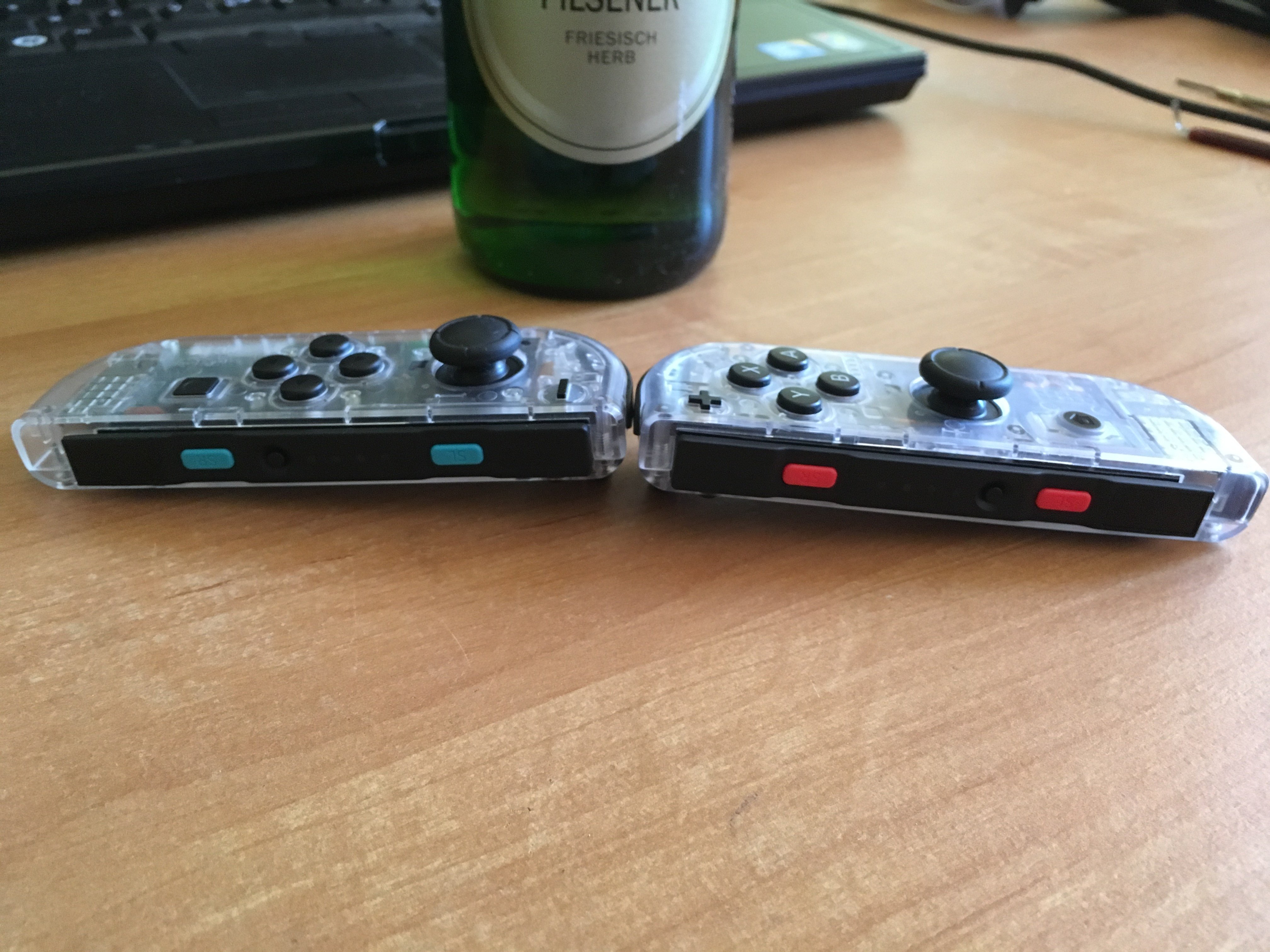

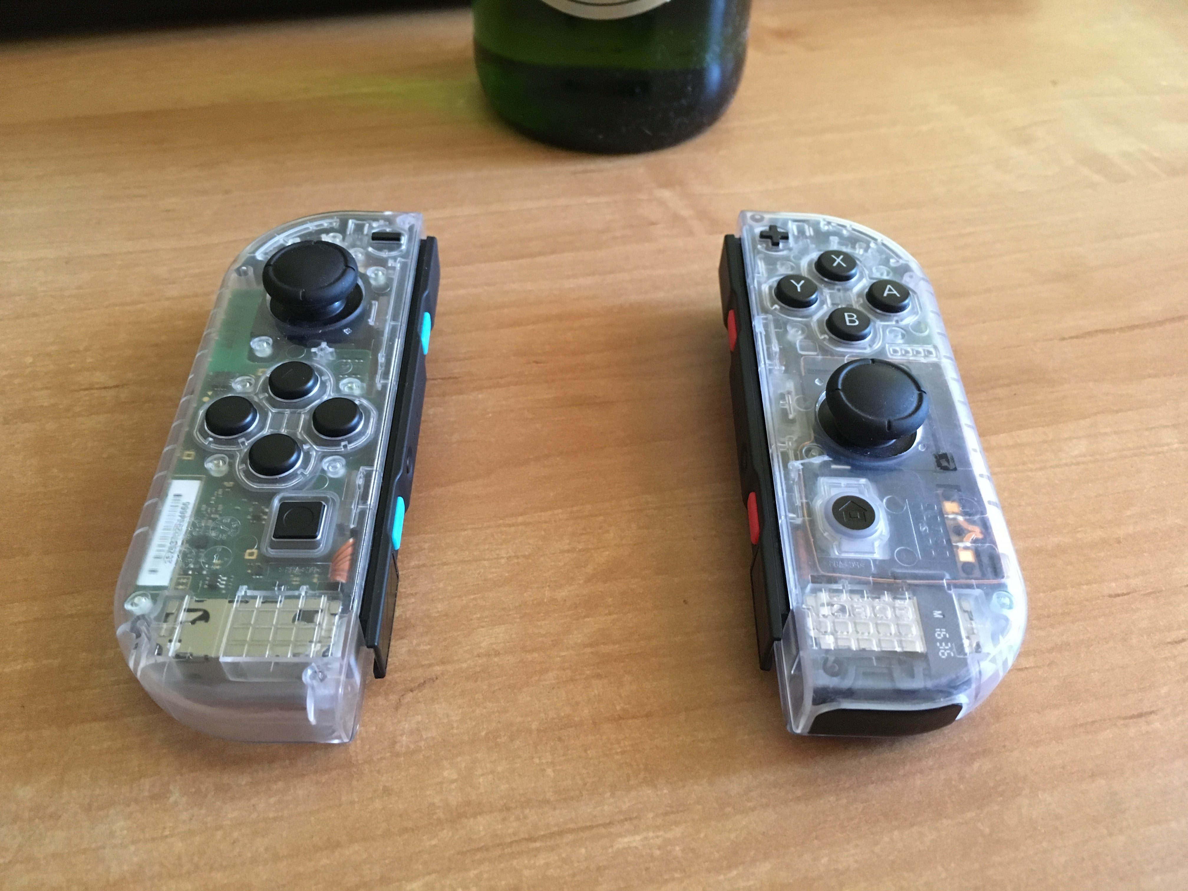

Umm do you have by any chance your flight mode on ? ;)
oh and here are my new shells
unfortunately the right shell dont fit perfectly. i have a little (1mm) gap between the rail and the upper shell. I already took them apart again but didnt find an issue.
I have the same gap problem with my atomic purple one, I'm glad that I'm not the only one
I saw on AliExpress that they had "updated" the shells to fix the gap. There were a lot of comments about it on Amazon too. Not sure if the ones on Amazon are updated shells but they're up on AliExpress.
Well, I bought mine from Amazon so apparently still the old ones there. Thanks for the Info, I consider to send them back then.
Edit: here is a little workaround for this issue
https://www.reddit.com/r/NintendoSw...ight_trimming_needed_for_myriann_replacement/

Does it work when directly connected to the switch in handheld?
So I’ve re-opened and re-wired everything. Now it
A) no longer detects EITHER of the joycons on handheld mode
B) was able to connect left joycon via pressing sync button (still not detecting handheld mode)
C) left joycon shows charging but right one does not.
This is a work in progress folks. Ive ordered a for-parts joycon off eBay and a rail ribbon for my right joycon. If you want my advice, DO NOT DISSASSEMBLE THE RAIL FROM THE MAIN UNIT. It seems my issues stem from the ribbons that attach from the rail to the main unit which do not need to be deattached at any point for these mods.
