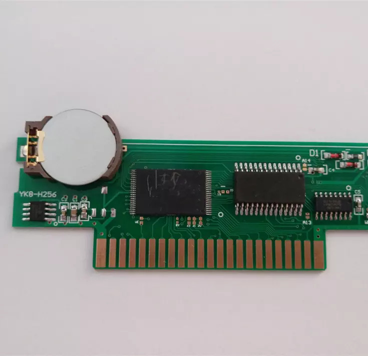

I wanna buy this ZELDA a Link to the past PAL cartridge, but im unsure if this is fake or not.
Can you hlep please?

I've never seen Nintendo putting in a battery holder instead of a battery with solder tabs. They should have done it for sure, but the battery holder alone doesn't look very genuine.

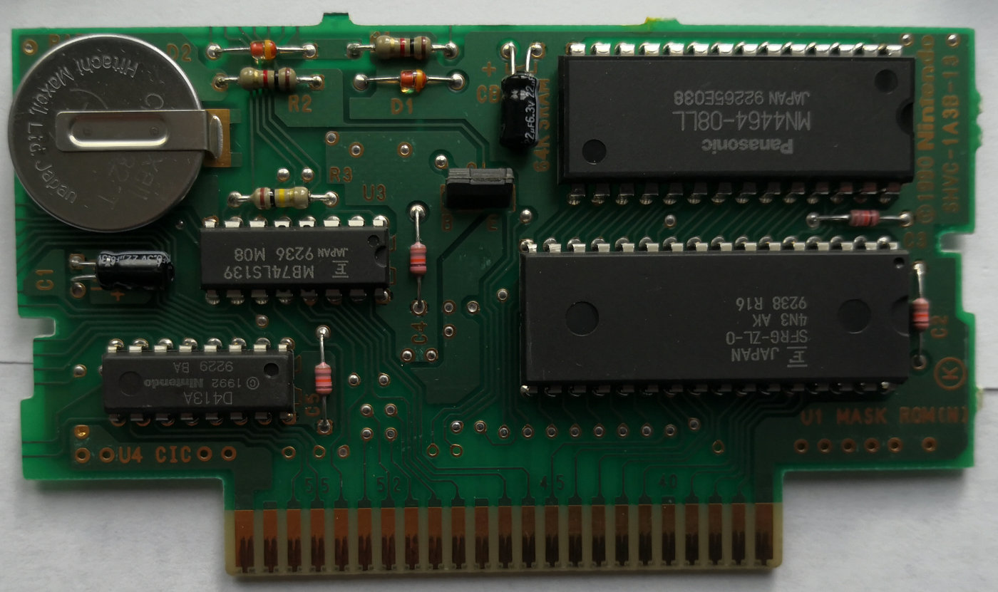

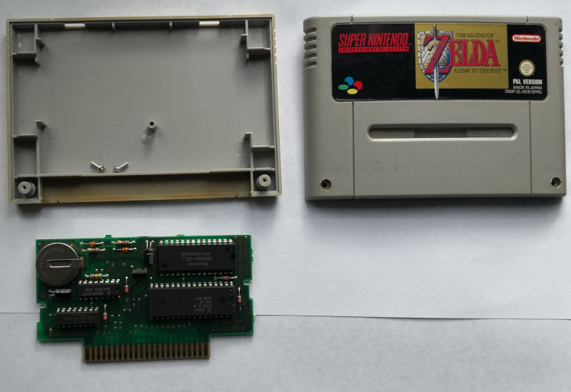

Scolding myself:
"Sinchen, don't be that lazy, open that thing up and take some pictures!"
As far as I know genuine A Link to the Past (PAL):
(Full pictures are below 250KB together, should be safe for clicking on with slow connection or limited data volume)

All authentic Nintendo PCB and cartridges have their name printed on them. That alone missing from the PCB in the og post is already evidence enough it's a reproduction.
Note, just because Nintendo is printed on something doesn't make it authentic, but it missing definitely makes it not authentic. At least for their game cartridges.
