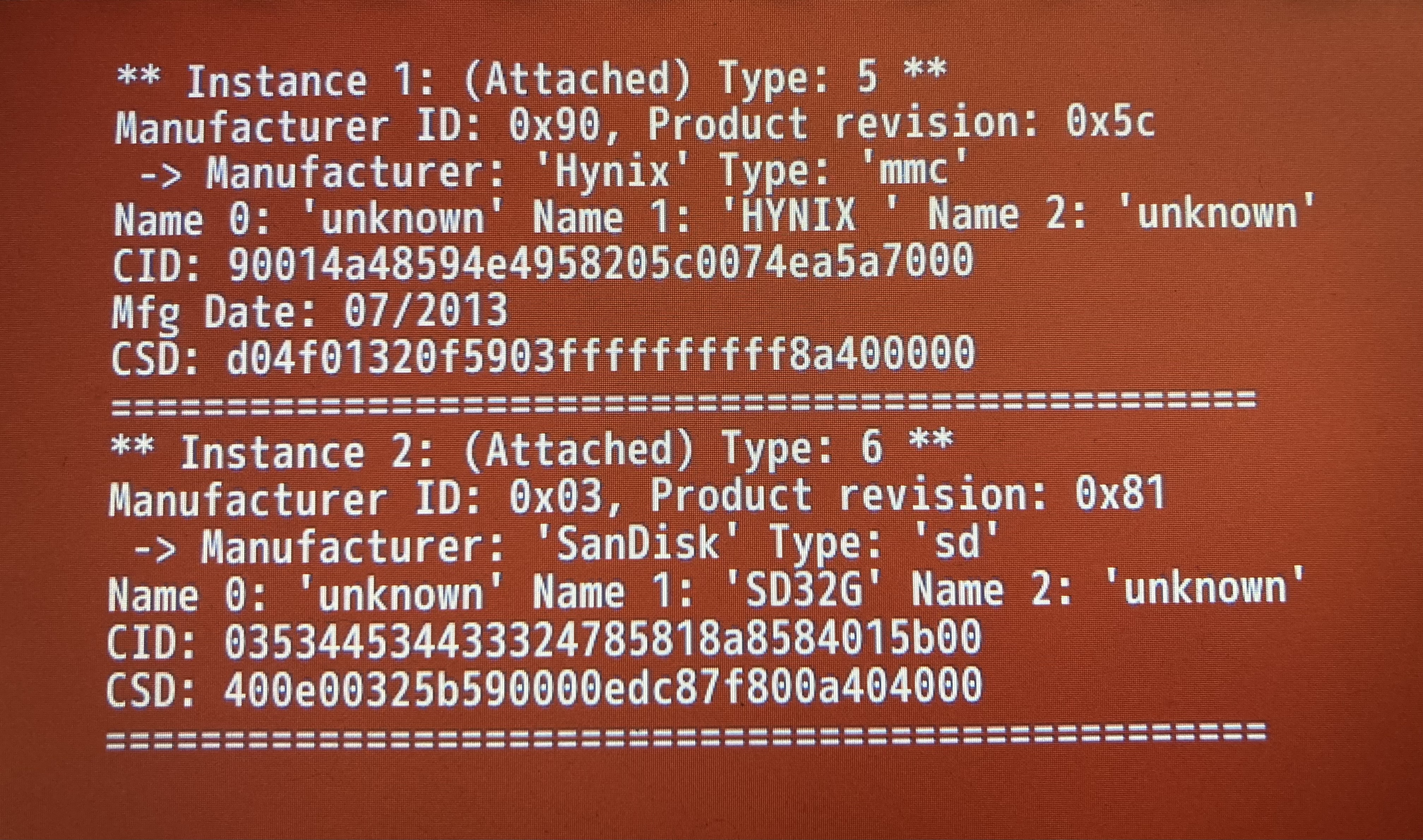

Manufacture date is 07/2013
You will run into issues if you surpass the write/read cycles of the MLC chip, but even then it takes one whole year of being powered off (after that) to start corrupting data. I personally have a Samsung launch unit, have been heavily using the console for over 4 years (6 years of light use after that) and it works tha same as day one. Assuming your Hynix chip is not bad, you shouldn't run into issues. (Since your console hasn't show problems yet, I assume your console is from a good batch)

that's good to know! is there any way to check the integrity of my Hynix chip to see if there any signs of a future failure?

That is pretty late, there is good chance the problem was already fixed by then.
You can run the MLC Checker from the reovery to see if there are any corrpted files and you can dump it to see if the eMMC reports any errors during that
