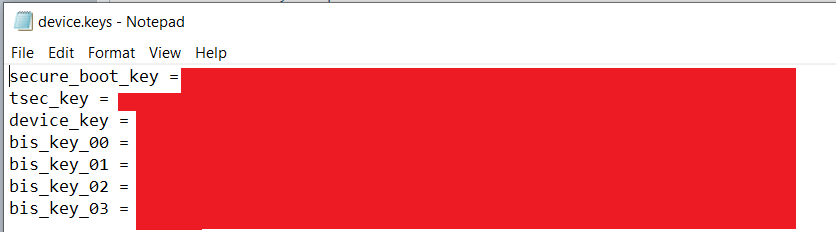

I'm facing a problem. When I dump my bis keys with biskeydumpv9, I get these
Which one is the bis key 2 crypto and which one is the tweak? Same question applies for bis key 3 crypto and tweak. Thanks in advance.​
