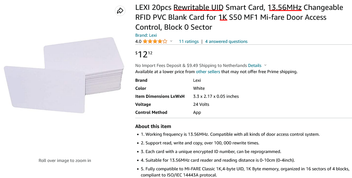

Requirements (Links for amazon are examples you don't have to buy exactly those)
  1. Install the drivers for your NFC Reader/Writer
For example look for cards/tags that have these 3 things in their name:
