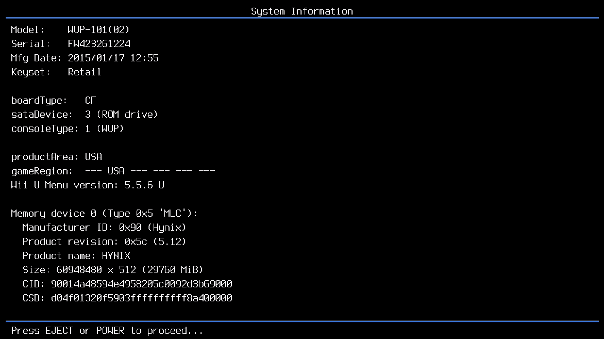

Here's my Sys Info from UDPIH for record keeping purposes. once i get my other, vanilla, wii u back from a friend i'll dump it for safe keeping and get a sys info shot from it as well.
