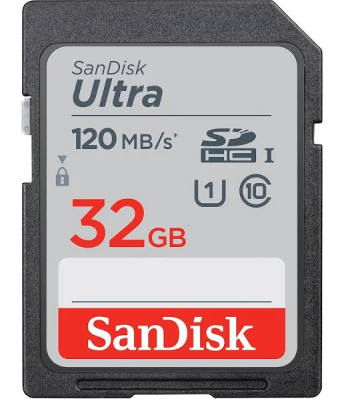

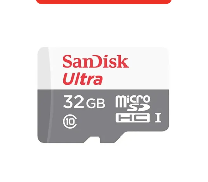

can I use Sandisk Ultra Micro SDHC 32GB while using a kingston adapter to sd card or a usb adapter or does it have problems
and this other one I really wanted to buy but not really sure as the compatibility list
preferably, should I buy the Sandisk Ultra SDHC Class 10 UHS-I 32GB Memory Card
and I also wonder if i should get the 64gb instead of the 32gb of this, I'm scared that It might fail
I don't see why it wouldn't (for both SD slot & USB2 adapter). Mine works with up to 512gb. Just buy them from a reputable outlet.
You'll find that it's more stable with faster transfers. But, I use Samsung evo+ SDXC.
You can also try to use the slow format. Yeah, ZZzzz, but it may just prepare the format a little better. BTW - How old is it ?

If so, do you know any third party software that I might be able to use to format a 64gb sd card to fat32? as I don't know if my pc would suggest such format FOR the SD card but I do know that flash drives do so ... Yeah, do you know any third party software to format an sd card to fat32?
As I stated - Get a micro SD to USB2 adapter. You can use your micro SD in both, USB2 adapter & the usual SD adapter.
Flash drives are great on a PC, but erratic with the Wii & other USB gadgets.
Formatting - Use Fat32GUI formatter (use USB adapter with micro SD).
Just double check that the clusters are 32k (after formatting). It sometimes has a tendency to do it as 16k clusters.
Do buy good ones, with reputable names/brands. Stay away from cheap ebay prices. They are usually fakes. They look like the real deal, but it will bite you in the ass.

I forgot to update, so yeah last month after christmas, I got a Sandisk Ultra SDHC Class 10 UHS-I 64GB Memory Card. It works great and I got lots of games now, and also considering of using emunand for wiiware games on my 2gb riidata sd card.
I also learned that if my usb loader gx is not showing any of my games despite showing up before, including new ones that have been added, just replace the app's files with the same copy from last time you downloaded your usbloader gx from and remount the sd card and boom it shows up again fixed and gladly not a cause of a corrupted game file.
