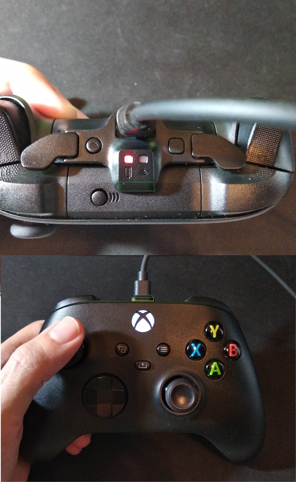

@AKNES
The non connecting issue happened again:
Mode X - connected by Bluetooth to PC
Battery depleted while playing - controller disconnected due to lack of power
Connected cable to USB port, this time, on the same computer I'm playing on
Pressed pair button on Superpack
Red light is blinking, Green light starts blinking
Green light stops blinking after 2~3 seconds, controller refuses to pair
I believe this is caused by the battery being low, so the controller refuses to turn on, even if it's connected to a power source by cable. While I was writing this post, it charged for some seconds/minutes, I pressed the pair button on the Superpack, and it connected normally.
This prevents the player from resuming play right away and while it's not that serious, it may be annoying to the more impatient people.

From your description, this seems to be related to battery power. I contacted RetroFlag to see if it could be resolved from our production side.

Still using the Superpack. I think the LEDs should be facing the user. Currently, the positioning of the LEDs means that during a game session, the battery led may start blinking, completely deplete, and the user may not notice it.
But, how to facing the user?:rofl:
The most visible part, most likely to catch the user's line of sight/attention, is the green outlined.
I haven't disassembled the Superpack, but these are probably SMD LEDs routing the light through transparent plastic pieces.
These pieces could be extended in order to have the light more visible. Would require some plastic rework.
Meanwhile, it happened again today, during a game session:
My character froze in place during action, controller suddenly seems unresponsive, I get hit ingame.
I flip the controller, notice the red light blinking, and the green light off - because the controller disconnected due to a depleted battery, and I was completely unware because the LEDs just aren't visible when naturally holding the controller.
