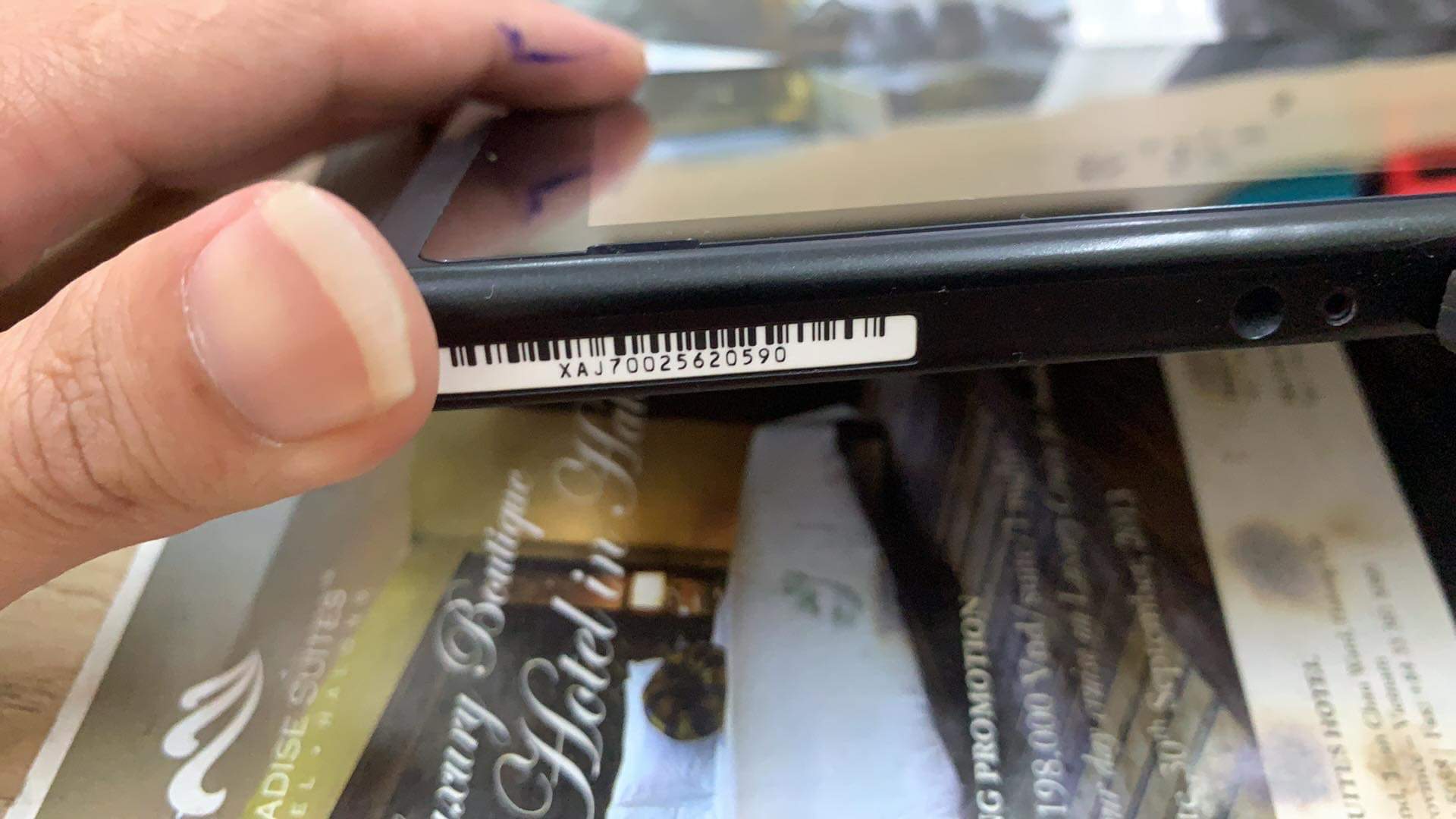

My friend has a hackable V1 Switch that he didn't hack and just played normally until one day it can't be booted for some reasons.
We tried to hack it to see if it can boot or not. It can still boot into Hekate and get to the Atmosphere screen but unable to get into both OFW and CFW (like in the video).
Anyone has any ideas what I can do or maybe a guide I can follow?
