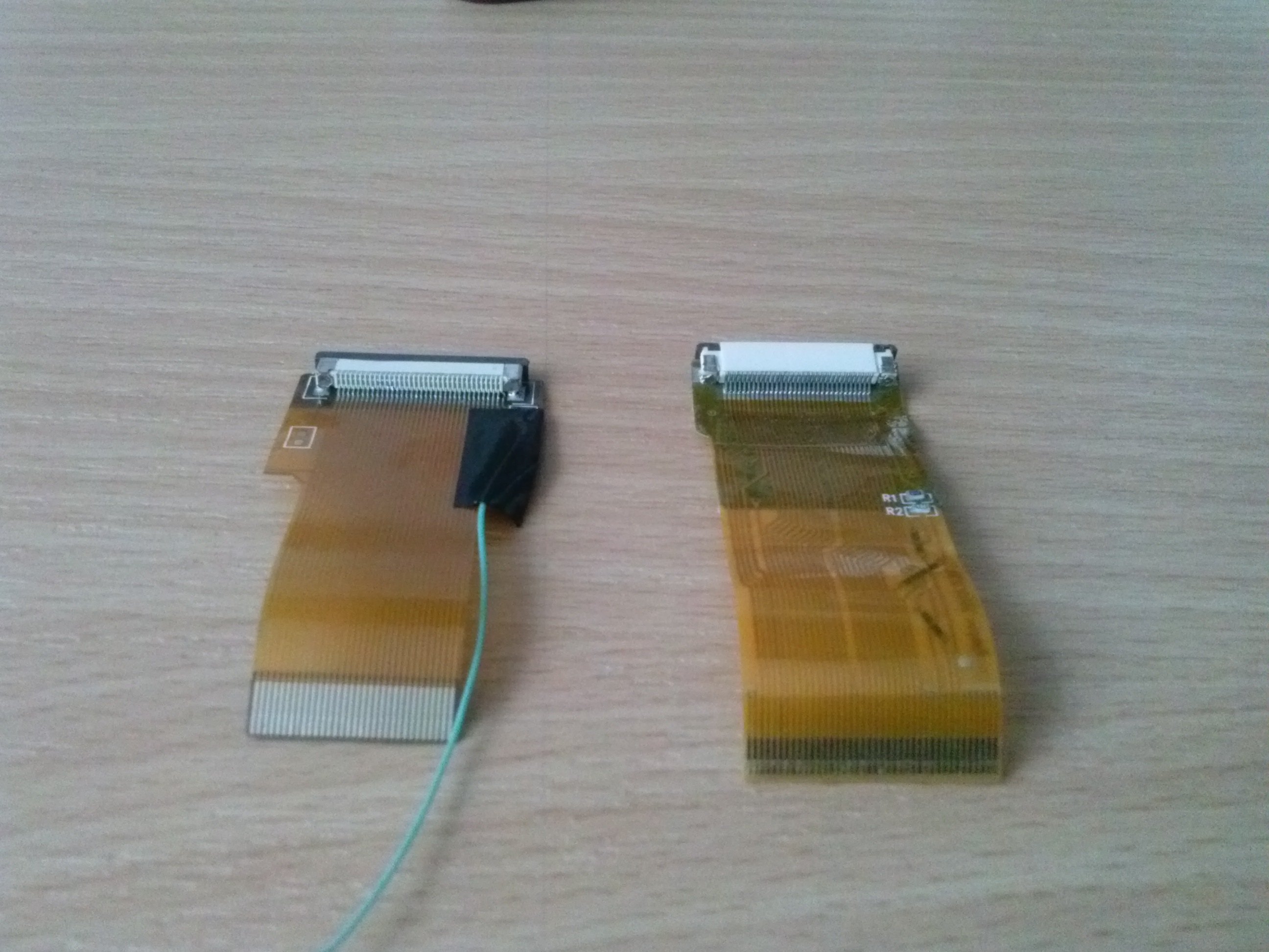

Hmm. I have a ribbon cables (shown on picture below). On the left is a 32 pin ribbon cable with cable soldered. On the right I have a ribbon cable that is 32 pin into 40 pin from GBA. I connected this 2 cables (didn't soldier the cable to motherboard), screen and motherboard (1 with missing resistor and 1 with missing condenser). Screen didn't worked good in this combination. When I moved/touched/whatever I did, the screen was inverted, really fuzzy etc... Missing parts in motherboards can be the cause?

If I get it right, you used two ribbon cables together. You are supposed to use only one. Use the one that fits motherboard's socket.

and I think that Mastah to due. You must choose the right cable (32 or 40 according to the motherboard you have ) and not to a combination between two cable.
