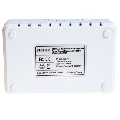

Well then, good news are that I managed to disassemble the thing without damaging the casing. It's quite sturdy.
Bad news is that I'm not really confident in my soldering skills and I have no idea where to start.
Just in case, here are some photos. Now I'm pretty sure it's a Ralink based chip, but I'm not sure if it's an a5-v11,
This one looks like the variant without serial debug breakouts. :(
If that's the case, what are my alternatives?
EDIT: I found out the same vendor I bought from also sold a rebranded TP-Link router with a specific header. Maybe I could compile a firmware update with the same header and try the update method?
EDIT2: Nevermind, updating is useless without uboot, am I out of alternatives then?
