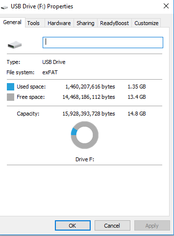

i tried diffrent sd cards micro sd cards and nothing work.. i tried fat32 and exfat with 32k allocation size and nothing works..

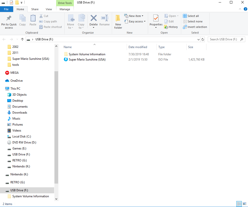

Can you post a picture of your SD card files and folders? And the ISO you are trying to load...

in every sd card i have expet from the 2gb that has swiss and all stuff it looks like that

Oh… sad. I see you tried exFAT and it did not work for you. Already said it was a long shot… Process of elimination:
  • Different SDs from different manufacturers in different sizes → not likely a problem with all SDs
  • Reformatted multiple times →not likely a problem with the filesystem
  • Have you verified the images to be good dumps? Check the images after writing them onto an SD with a checksum tool like md5sum, crc32, sha1sum…
    • compare the checksums on your hardrive with those on the SDs and/or
    • with the data inside gc.dat
  • Try a different SD-reader/writer and/or a different computer like toxic9 already suggested
  • Can you load any gc homebrew apps from SD gecko with Swiss?
    • Trying a different SD-Gecko is a good idea just to make sure
    • Also try the other Memory Card slot (if not already done)
I had a microSD card that didn't work with any games and another one fixed the issues
That is my experience too. It took me a while to find an SD that fully works on the cube. And I can rule out all other possible causes of error like bad/fake/dying SD, bad reader, bad filesystem, problem with the computer as I checked all of this. None of the tested SDs made trouble on any other device than the good old cube.
I finally had success with exFAT which was kind of baffling.

ok my problem solved
