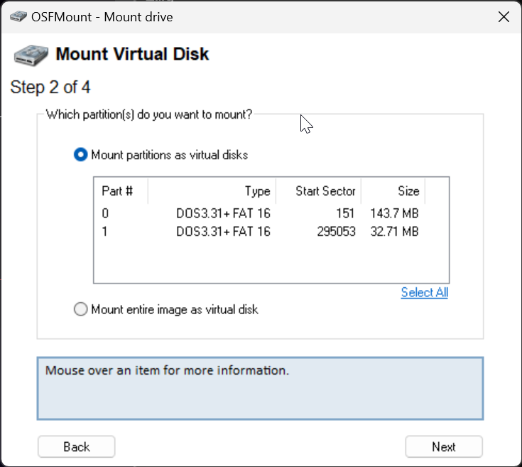

OSFMount can mount single filesystem images as well as partitioned images, so in this case it supports ctrnand_fat (single filesystem image), ctrnand_full (partitioned drive with one partition) and twlnand_full (which has two partitions).
If you mount twlnand_full.img for example:
Screenshot of an OSFMount window, Mount Virtual Disk, showing the option of mounting individual partitions of a disk, or the entire disk.
If OSFMount isn't accepting the file, it's probably just corrupt. Or maybe there's a bug in ninfs (but check to see if it can't be decrypted with different tools before assuming this).
If you really need to get the individual FAT partitions, I'm not sure how to do this on Windows at the moment. You could probably script it yourself with a library like pymbr. On Linux and macOS this could be done by attaching the drive and dd-ing the correct partition from /dev.
