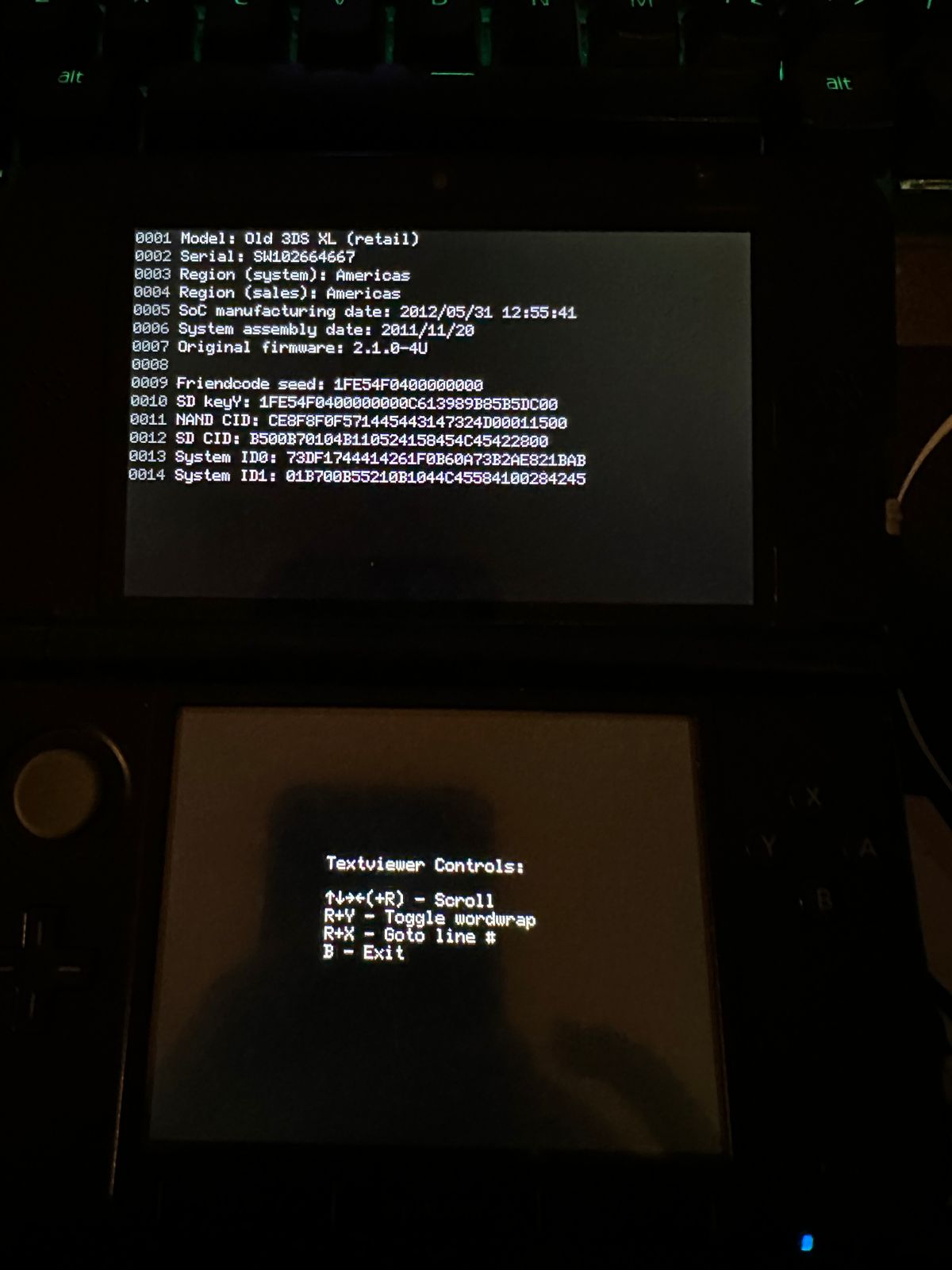

hi, good nite to all
Sorry for typing in spanish (im mexican and my english its not the best)
i have an old 3ds xl american region
i bought the console with the hack already, i trying to delete the hack and kept the console "legit" (i want to purchase the games)
so if delete the hax from godmode using the script, i did the combination and when i reboot the console i get a black screen and a solid blue led
i did everything i saw on internet and youtube, i did the ctrtransfer, i did ctrtransfer using godmode (i even did ctrtransfer clicking in the ctr image directly) i use CTRTransfer (Type D9), i use some videos on spanish with blue lazarus (the one for blue screens) and black lazarus (the one for black screens, like i had)
and no one could revive my console, the only thing finish the script is i only get black screen or sometimes i ended with a warning saying "preparing home menu, dont turn off the console" i let the console for hours and days but nothing happen
the only thing i didnt trying (yet) is the hardmod
By today there is no need to "uninstall" hacks, the 3DS lifetime is over so you will not be able to use any legit software with out hacking the console anyway.
"Uninstall" Hacks can lead to a brick as you discovered.
As stated, use the NTRBoot method to reinstall all hacks. read the guide:
https://3ds.hacks.guide/installing-boot9strap-(ntrboot)
OR by today as the Ninty servers are active use the System Recovery method:
Start the console on "safe mode" by pressing and hold R+L+A+Up on the D-Pad and then hit the power button.
The system start on SYSTEM UPDATE mode and can connect to internet to Update the Firmware System.
After That reinstall NTRBoot

right now i can access to luma and godmode
i cant access to recovery menu, i only get black screen when i try the combination

yes, i already did that,
i install safeb9s using this guide 3ds.hacks.guide/updating-b9s
i already install boot9strap through godmode using the script
but again, i have no luck, black screen again and cant access to recovery
im trying to do the script lazarus 3ds
i have everything to do it, but in the sha verification i always get error of sha
anyone know how to solve this issue?
