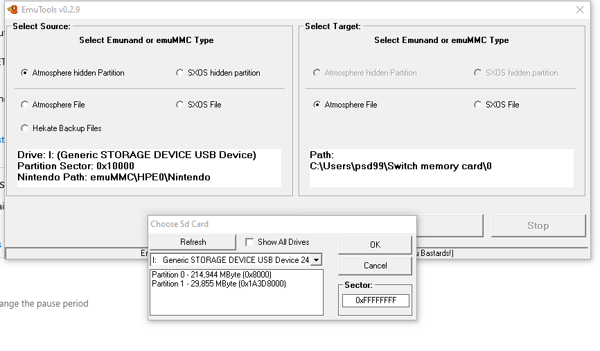

Psd99
Oct 1, 2021
404
123
810
im trying to migrate to a new memory card (more space)
im running atmosphere, i see two partitions in eum tools:
do I need to copy each partition over individually?
I think my setup is atmosphere hidden but a bit unsure.
ok so I got a prompt asking me to copy the "nintendo" folder from the SD card to the location I saved the card to the PC - where exactly does it need to go? it is about 200GB that folder is.
Hayato213
Dec 26, 2015
20,150
21,410
The 29GB is your hidden partition emunand, the 214,944MB is the rest of the card.
Reactions: impeeza
impeeza
¡Kabito!
Apr 5, 2011
6,658
46
At my chair.
19,834
Colombia
Nop the first one is your normal dara partition. Ans the 29 gigabyte is the raw partition you need to backup
Psd99
Oct 1, 2021
404
123
810
ok thanks, Im a bit confused on how to get the whole thing copied over correctly. Instructions are a bit confusing.
whats the deal with the EmuTools sofware? is it copying over all files except games? The bulk of the files look like they are in the nintendo folder. ie the size of the nintendo folder is very much all of the data
Hayato213
Dec 26, 2015
20,150
21,410
https://gbatemp.net/threads/how-to-...en-partitions-on-the-same-sd-tutorial.601607/
Hopefully this help you just need to make a 29.2GB Allocated partition on the new card then restore the file based emunand onto new card.
Resize FAT32 Partition and Make New Hidden Partition
THIS WILL MAKE ROOM FOR A SECOND HIDDEN PARTITION.
Now we will RESIZE your FAT32 Partition to leave a 29.2GB Unallocated Partition at the end of the SD
  1. Open MiniTool Partition Wizard
  2. Find the TARGET SD
  3. Right Click on the FAT32 partition
  4. Select Resize
  5. Reduce the size of the FAT32 Partition by 29.2GB using the slider. Make sure that the unllocated space AFTER the FAT32 partition is 29.2GB and DON'T MESS WITH THE UNALLOCATED SPACE BEFORE THE FAT32 PARTITION! THIS IS SXOS EMUNAND!!
  6. Press OK
  7. Right Click on the New Unallocated Partition after the FAT32 partition. (once again not the first one. That is your SXOS Partition.)
  8. Click CREATE
  9. In the "CREATE NEW PARTITION" window Select the following:
    1. Create As: PRIMARY
    2. Drive Letter: NONE
    3. File System: UNFORMATTED
    4. Cluster Size:; NONE
    5. Click OK
  10. In the MAIN WINDOW press Apply
That should format the unallocated space so the tools can see it.
Make new Atmosphere Hidden Partition EmuNAND
In EmuTool
  1. Under "Select source" select Atmosphere files (Or hekate back up files if that's what you have)
  2. Select "Click to select SD Card" and point to the Converted SXOS to Atmosphere Backup files (SX2ATMOemu) or your Atmosphere Backup, You must point to the directory with the BOOT1 BOOT2 00,01 etc etc files, Probably emummc\(A Numeric Code)\eMMC\
  3. Under "Select Target" Select Atmosphere Hidden partition
  4. Select "Click to select SD card" and point to your Target SD card.
  5. Press START.
Restore SD backup and install Atmosphere
If all went well you should be able to copy your SD files you backed up in the beginning of the guide. That should get SXOS back up and running. then you can install Atmosphere. There are a TON of guides. just get the newest SDfiles and toss them on the SD. You'll need sigpatches too if you want to play downloaded content.
  1. Copy FILES YOU BACKED UP IN THE BEGINNING OF THE GUIDE back to the SD FAT32 Partition .
  2. Copy all Atmosphere files to your SD
  3. Copy Sigpatches to the SD
If you are converted your EmuNAND from SXOS to Atmosphere and you didn't shrink your EmuNAND you need to copy the files in the EMUTENDO folder contents from SXOS to the Atmosphere NINTENDO folder (emuMMC/XXXX/Nintendo, XXXX is a Alpha Numeric 4 digit ID) this should make everything compatible work.
(Remember games installed with the built in SXOS installer will probably need to be reinstalled.)
Make EmuNAND visible to Atmosphere.
  1. Unzip Hekate files to the ROOT of your SD.
  2. Insert SD in to the Switch
  3. Boot Hekate using the hekate payload and your favorite payload launching method.
  4. Select EmuMMC
  5. Select Migrate EmuMMC
  6. Select Fix Raw
  7. Select OK
So this is what you need to do
  • Love
Reactions: Psd99 and impeeza
