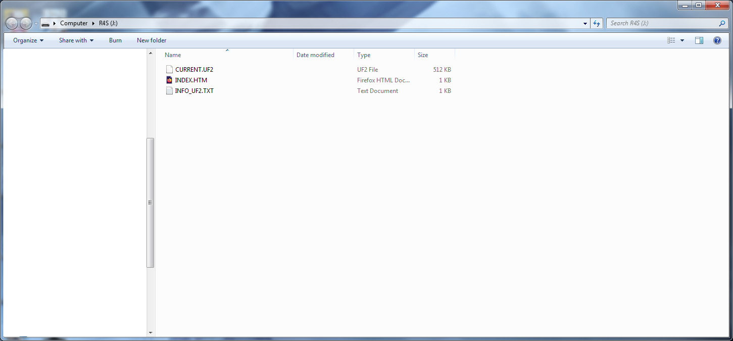

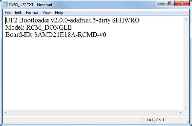

Hello again and thank you for your answer. Looking at the github your file was named dragonboot_1-00.uf2 but the one in my R4S dongle was named CURRENT.UF2 . Do I have to change your file name to CURRENT.UF2 or can I just put it in as is ?
and could you please confirm if my R4S could work with your dragonboot ?
To tell the truth I'm quite a noob and this dongle is second-handed so I don't even know what that CURRENT.UF2 was supposed to be doing. The way I used this dongle was to plug it in with switch along with jig and then hold volume+ with power button which would bring me to hekate menu, at which point I would choose payload then > fusee.bin and it would boot into atmos. Would this qualify my R4S to work with dragonboot ?

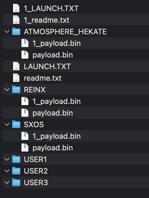

I have a noob question, the structure of my RCM load looks like this, where should I put the dragonboot .bin file? I only ever run atmosphere (no hekate or other things).
Doesn't matter as long as you change the payload on the dongle via the little plus button. I dunno why, but putting payloads into the hekate or atmosphere folders never worked for me. That's why i putted payloads like this or lockpick for example in the USER1, USER2 or USER3 folders.
It can go in any of the folders as long as you've selected the corresponding color using the dongle button and LED. Note that in case it wasn't obvious, you'll have to rename dragonboot.bin to payload.bin.
For instance, I have no desire to purchase SX OS, so I threw it in the SXOS folder, renamed to payload.bin. In order to launch it, I need to hit the plus button on the dongle until the LED turns red.
It looks like you have two payloads in each folder, the one with the prefix 1_ is not used, and is probably a backup of the original that came with your RCM Loader. Considering the space is limited on this device, you might consider deleting those. Anyway, you chose the right payload for a replacement. You can copy it to every folder, and of course renaming to payload.bin. That way, it won't matter which led color you're using at the moment.
