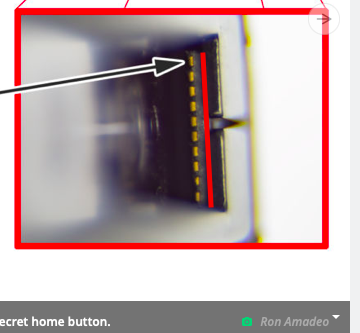

my go to fix for the loose fitting joy con rails is a little shim of card in between where they connect, even with normal use the little plastic clip at the bottom ends up not springing back into place quite right but it does seem to be a lot more common with the use if rcm jigs especially ill fitting jigs
a thin piece of card in where I drew the red line will give much better joy con recognition, you can also just bend it back, but it will start disconnecting randomly again after a little while
My left joy-con still disconnects occasionally even with the metal latch, so I might try this sometime, thanks for the tip

I take it everyone knows about the drift fix with the piece of card?? I'm not actually suffering from drift but I may as well so this at the same time.
yeah I have fixed quite a few switches and this appears to be a fairly common issue on either joy con rail so its not just a rcm jig issue, but more a design flaw/general wear and tear, that little bit on the rail actually moves on a small hinge eventually it ends up pressed hard against the metal making the connection between the joy con and the connectors ever so slightly loose fitting so you will get the occasional joy con disconnected pop up while playing in handheld mode, I did use to replace the rails but it was additional cost that could be avoided with just a little bit of card, and I have had mine in my switch for a few years now and never had an issue, granted my switch was probably a very bad example as I was making and testing hundreds of rcm jigs when the exploit first released and a few of those jigs were slightly too big and tight fitting resulting in my own rail becoming very temperamental, PS. when you insert the card you can pop in the little gap on the metal rail to make it easier to insert the card between the connector and the metal rail, you could probably get a similar result just giving the rail a little bump on the slit so its the metal pushing the connector back into the correct position if you don't want a little piece of card in there. personally I just use a little piece of black craft card so its barely noticeable unless you're looking for it
