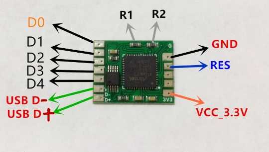

Hey there,
i have an idea about a Payload Injector. After searching in vain for a Dragoninjector because i really like the design, i thought about ways to replicate the function and design. And i got an idea. But it seems to easy so i wanna ask if im correct.
As a base i thought about using a RCM-X86 chip.
From the Install thread i concluded that id simply had to add a usb c plug where i only would have to connect D+, D- and GND. Also i would have to add a power source to 3V3 and GND and a Button to send the payload between the second last contact on the upper side of the pic and GND. Is this correct?? Also would there be any way to get the Power through the USB? In other words can i pull power out of the Switch through the USB Port?? Also i would have to install a Res switch between GND and the Contact right next to it right? To flash the Payloads as far as i understand it.

So to make it more clear here my questions:
Is my conclusion right about the injector working that way in principle?
Can i flash the payloads by pluging it into my pc and pressing the res button twice?
Can i somehow get power through the usb plug or do i have to include a battery of sorts?

Maybe this can help...
https://switchbrew.org/wiki/Gamecard
https://pinoutguide.com/Slots/usb-type-c_pinout.shtml
https://github.com/euclala/RCM-X86

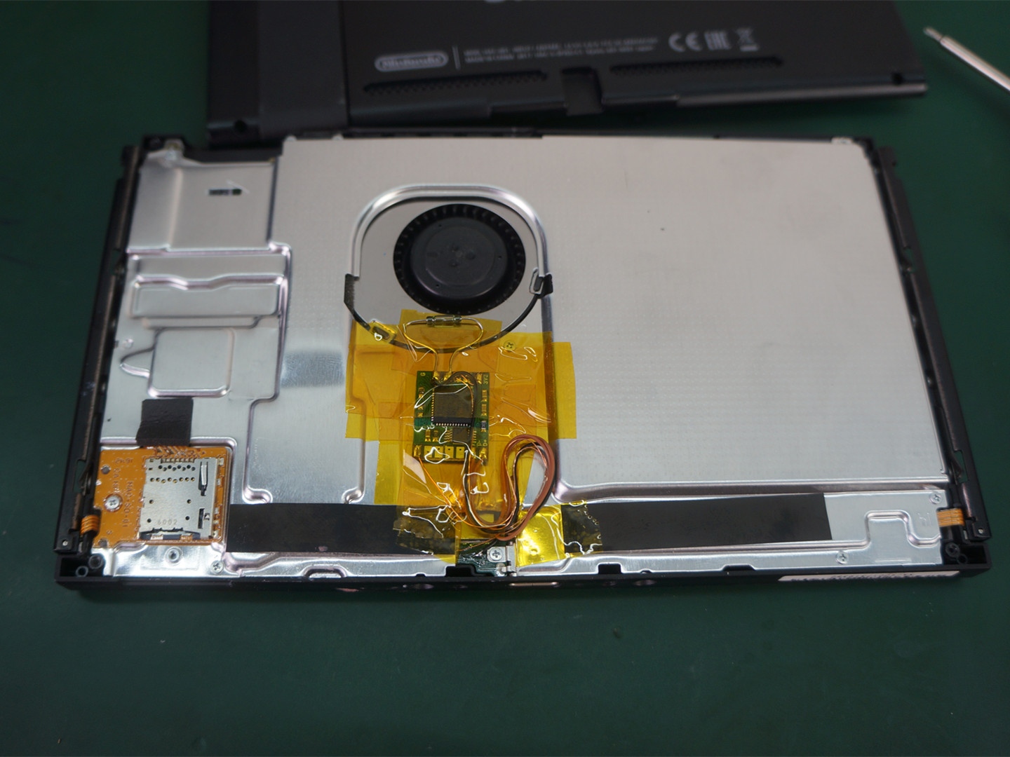

Also thought about installing a modchip, but im not comfortable with soldering on the switch boards itself. Its a bit too expensive to tinker with it just because of a minor inconvenience.
That's why I said for a $10 RCMLoader, is alot easier and no worries of messing up your switch. Is always fun to tinker, but at what costs. Good luck with your project though either way.

You can use that chip you listed as a payload injector, and make a small version like the RCMLoader, with a usb-c cable. Check that github page for example, but instead of soldering to switch, solder to usb-c cable.
