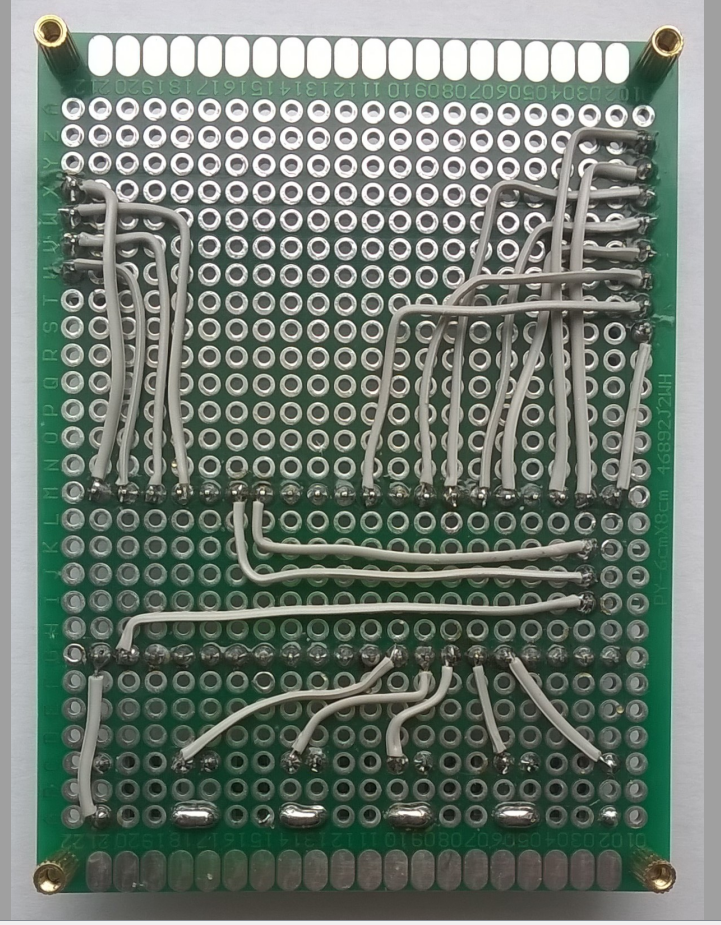

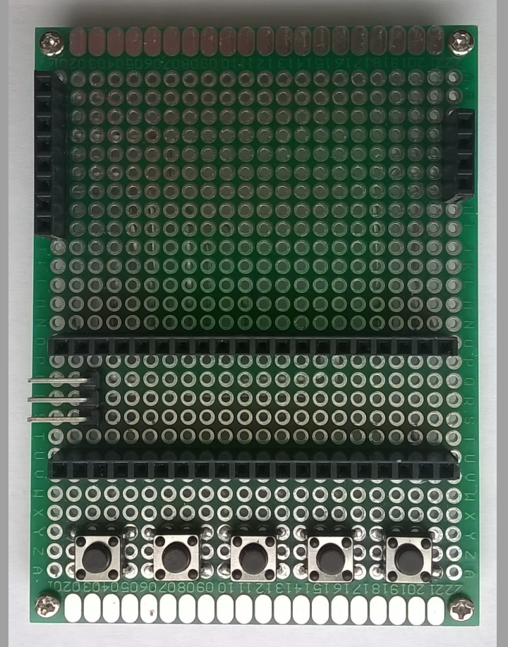

Does anyone have the original build using breadboard specs and wiring as pcb is expensive to have custom made here.
or hi res photos of one?

FYI, 5 Custom PCBs from jlcpcb including shipping is less than $8.00 thats cheaper than the proto board of that exact size :) if youre in the USA

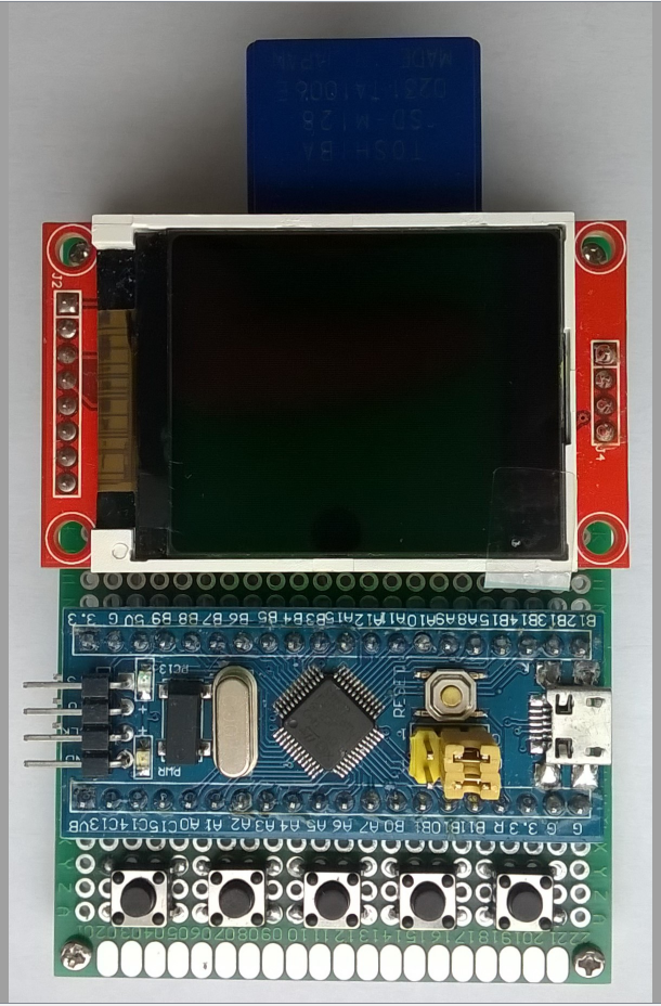

Brilliant, Placed an order with them. if anyone in uk is looking for spare board then hit me up.
Another question, I ordered a stm32 bluepill, but seller has contacted me to say its a csk chip, Will this work?
There is a 99% chance it will work, but it's not explicitly tested. It's a cheap clone of the original STM32 chip.
