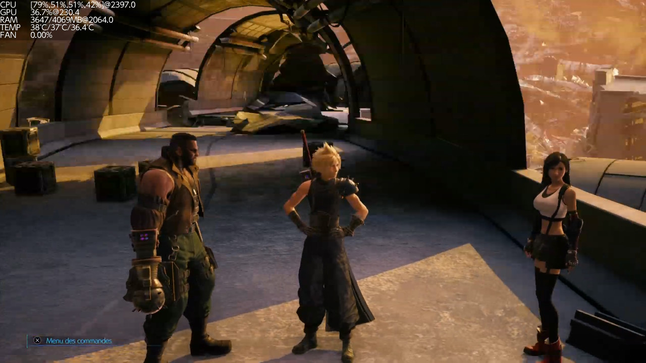

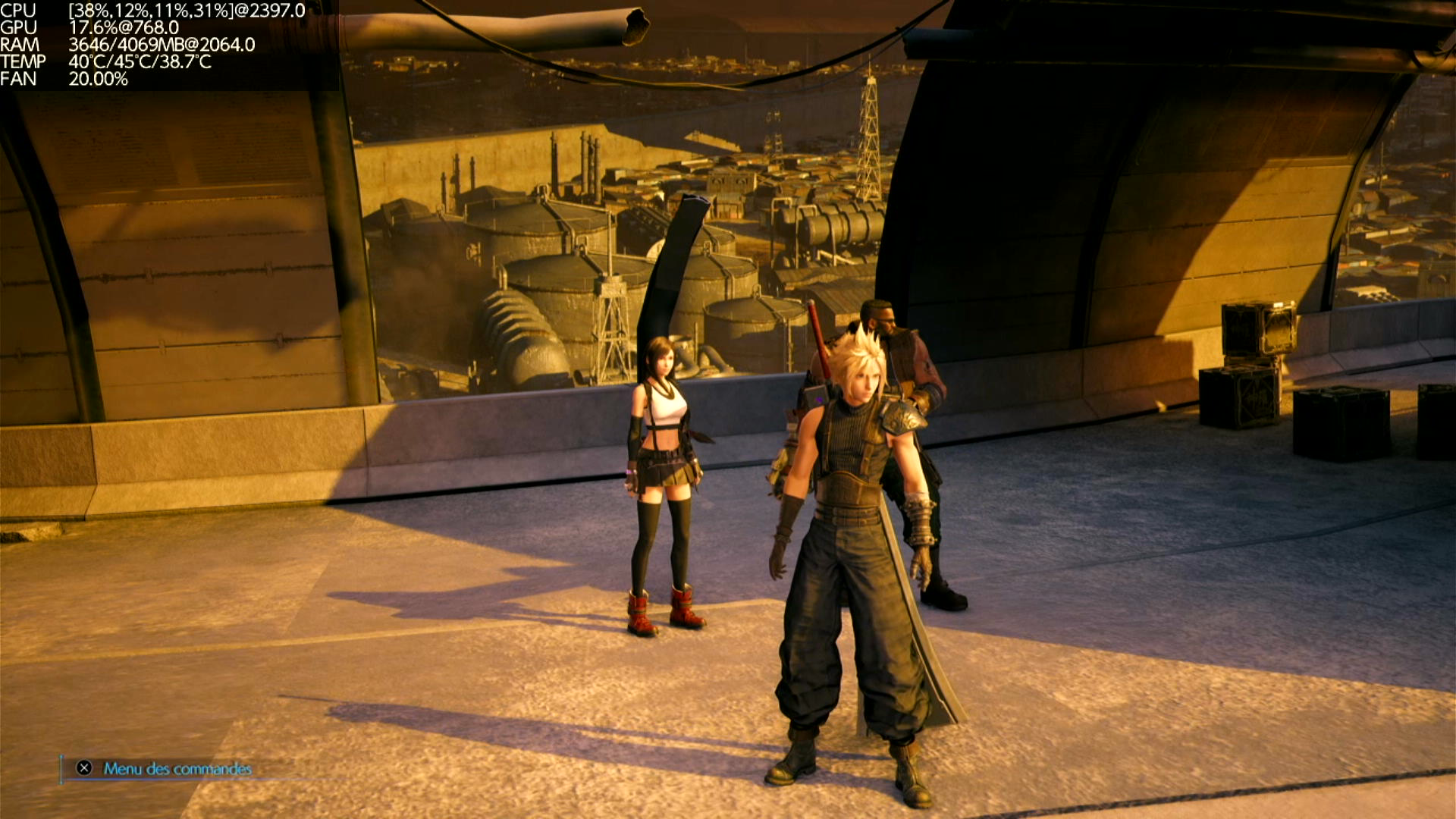

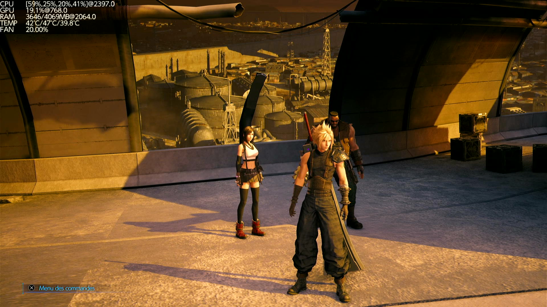

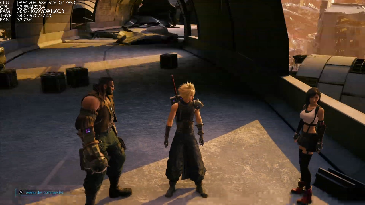

Yup, i play more than 15 hours on FFVII since then and it's a great experience on handled
(Don't mind the quality i take the screenshot when mooving the camera fast to stress the cpu)
As you can see on the picture the CPU Utilisation has much more headroom with 2397Mhz
It's not improving the quality from what i see, there is still some artefact when mooving the camera i think this is more related to the bitrate / Wifi connection but it fixes most issues Audio / Framedrop / Freeze
