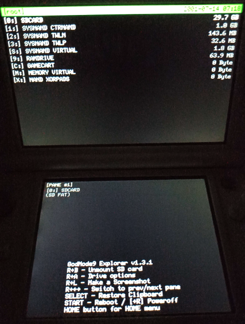

Now that the R4i-B9S has arrived, I tried following the ntrboot tutorial, but… the flashcard doesn’t appear when put into my 3DS. My 3DS does recognize normal 3DS carts, and normal DS carts (tried on a Japanese copy of Animal Crossing: Happy Home Designer, and a PAL copy of Pokémon Link (Trozei) and both loaded fine).
Not sure that’s meant to happen, so worried I went looking for more information, and found this tutorial; http://www.r4i-sdhc.com/down/b9s/The definitive guide to 3DS custom firmware.pdf from the r4i-sdhc website. I followed it and it worked… up until Step 13/14.
Following it, I can boot into godmode9 - I can run the copy_ntrboot script, etc.

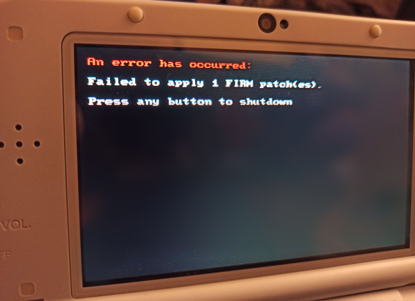

But after doing step 13;
  • The console will boot into Luma3DS configuration. Check these options (press A) then press start:
    -"Show NAND or user string in System Settings"
    -"Patch ARM9 access"
I then get an error, reading exactly;
“An error has occurred:
Failed to apply 1 FIRM patch(es).
Press any button to shutdown.”
Any subsequent attempts to load up the 3DS with that SD card in the slot without remove the luma/etc files that godmode9 put on there just results in the same error message showing on start-up.
I went back and did the tutorial again from the start, a couple of times, but all resulted in the same error.
Using my second SD card, I can now boot into this godmode9 menu no problem;
But any attempts to put in an SD card with cfw on it result in the never-ending black screen, or the error message if the SD card still has the files from post-step 12 of the r4i-sdhc tutorial on it.
However, the 3DS now boots up correctly after a few seconds with a blank SD card in it! So that’s progress... but I’m at a loss on where to go from here, with both the flashcart not being picked up my New 3DS XL (JPN region), and with it refusing to load if there’s any cfw on the SD card other than godmode9.

Please answer a few questions to make things a bit clearer.
  • Can you now boot into GodMode9 without ntrboot?
  • Did you use the "download package" linked in this highly questionable guide? It is grossly outdated and no wonder the old Luma3DS version throws the infamous "Failed to apply 1 FIRM patch(es)." with newer official firmware.
  • Can you access files on the SD if inserted after booting into GodMode9? Can you copy files from SD to RAMDRIVE?

Yes, R4i-B9S Flashcard is only for flashing the primary hack "boot9strap" to the 3DS by using a magnet and holding the button combo in sleep mode. The card will not appear in the System menu.
As we had this behavior with issues when a SD Card is insert. Check your SD-Card Slot as it may be dirty. Blow in it and try to clean it with IPA (Isopropanol).
This is the latest uptodate guide you should had followed to hack the system by NTRboot https://3ds.hacks.guide/installing-boot9strap-(ntrboot)
And you may try updating B9S to latest version (if 1.4 is not installed by the flashcard) https://3ds.hacks.guide/updating-b9s
EDIT: The Advantage of B9S 1.4 is, it can indicate errors of missing or corrupted boot.firm images.
If people would just stick to that. I've lost track of how many "definitive", "ultimate", "easy", "all-in-one", "updated", "best" and whatnot for praising adjectives guides are out there (including videos).
This one from the r4i-sdhc.com site above dates back to 2017 – as can be seen by GodMode9 v1.3.1 and Luma3DS v8.1.1 which are part of the packages. I'm astonished that the download links are not dead yet. Besides: The packages contain a lot of unneeded rubbish as well.
This shouldn't do harm, but it isn't really needed either. Other than on B9S v1.0 there shouldn't be a desperate need to update (oldest B9S version will only boot Luma3DS v7.1).
