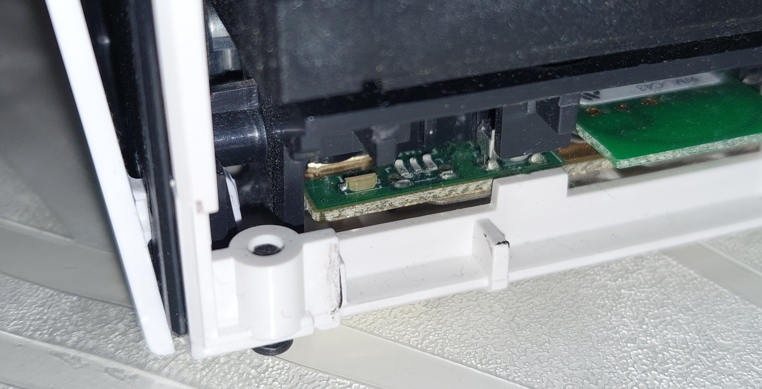

I recently acquired a Wii console with a broken power button and I'd like to fix it and possibly sell it afterwards. Turned out that the actual button on the board got separated from it and was moving around inside the case. I'm wondering if it would be possible to solder it back to where it was before and if there's a tutorial on that available somewhere? I have no soldering experience, but it could be as good as time as any to give it a try (it's a bit too tiny for a beginner, but I might be able to pull it off with proper guidance).

They... probably are, I'm afraid. I've attached some images so that you can check it out.

The 3 bent finger-like are broken of the switch & can be removed by de-soldering them. That part of the board looks good.
The end stabilizers pin-like would be the greater work-load. Not sure if they go fully through board (I doubt it). But cleaning it out for a new switch replacement could be harder. A solder vacuum/sucker would be great.
Not sure if switches are easily found these days.
The other option - You can just wire the pads to be on permanently & use the power button from a switch board or wall socket. It wouldn't make a good selling point though.
