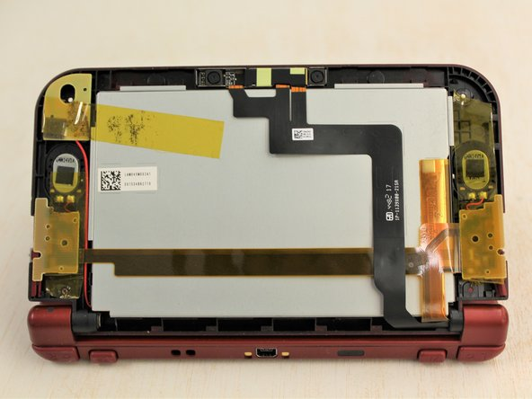

It worked! Thank You! But now I found that the cameras aren't working. I previously had opened the console to plug out and in the wifi cable and I don't know if I did something to the cameras. None of them work
Hayato213
Dec 26, 2015
19,952
20,983
The cable for the camera is behind the top screen
https://www.ifixit.com/Guide/Nintendo+3DS+XL+2015+Camera+Replacement/86337
