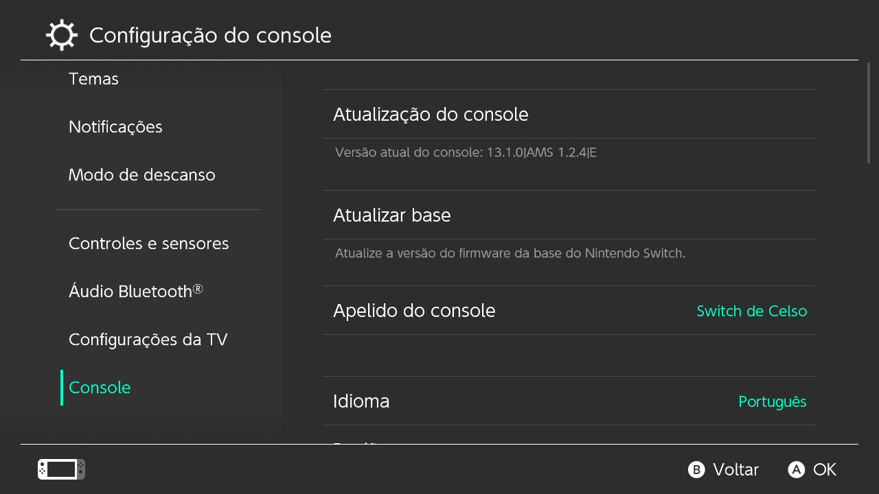

I have nintendo switch v1 on 13.1.0 with atmosphere on emunand, and i made a downgraded emunand with atmosphere to 11.0.0 and converted to sxos emunand format.

First you need to have latest atmosphere compatible with 13.1.0 and create second emunand (if you have one emunand SD00, the second will be SD001)

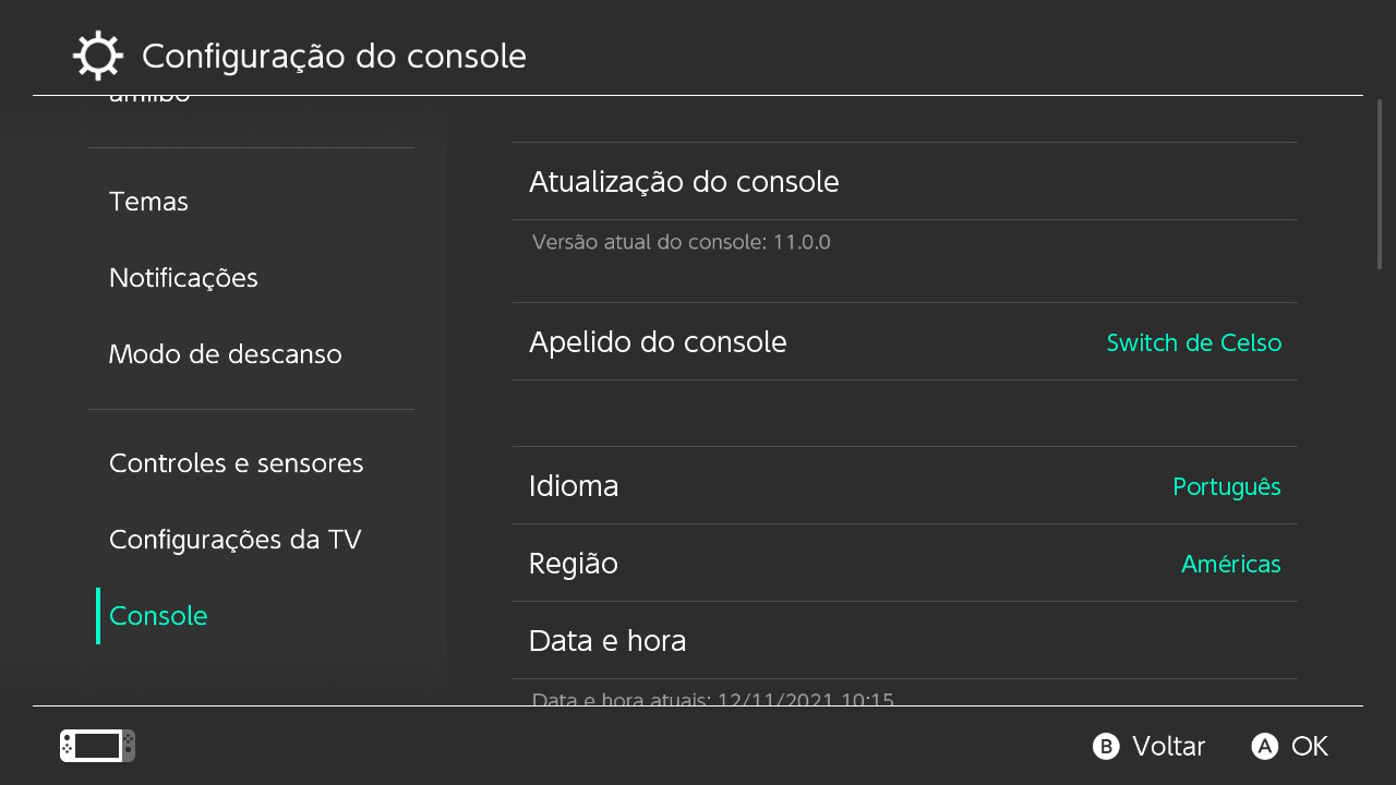

Open your AIO Switch Updater and go to firmwares and download 11.0.0, after open Day Break homebrew, navigate to firmware folder and install 11.0.0 on your emunand (SD01)
Your second emunand now downgraded to 11.0.0!!

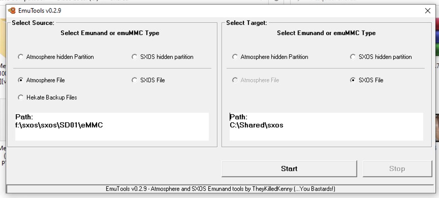

Now, we convert emummc from atmosphere to sxos format compatible.
You need to open the EmuTool.exe downloaded in zip of this tutorial,
select on the left: Atmosphere File and location of your eMMC folder on switch sdcard.
select on the right: SXOS file, and select path to export sxos emummc (folder on desktop or any folder).
After the program finish, you will have sxos folder with .bin files from emummc converted.

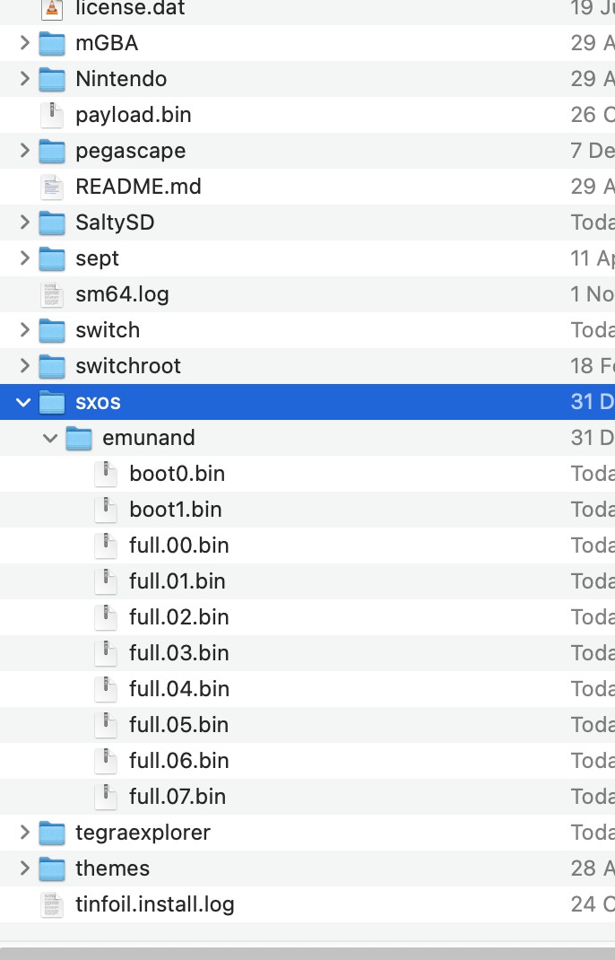

Go to switch sd card, remove the emuMMC/SD01 folder from your sdcard and paste sxos folder generated by emutool.exe on your switch sdcard root
like this:

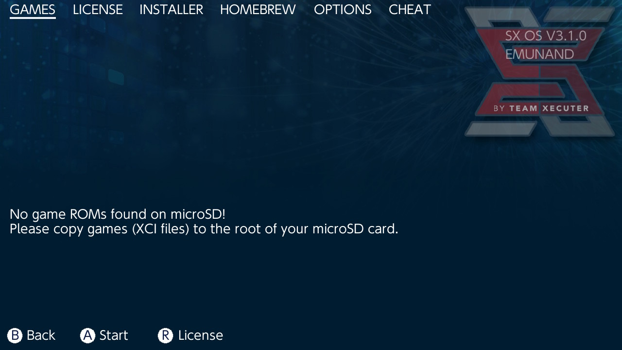

Now you can boot sxos on 11.0.0 by hekate clicking on sxos icon at boot menu...
