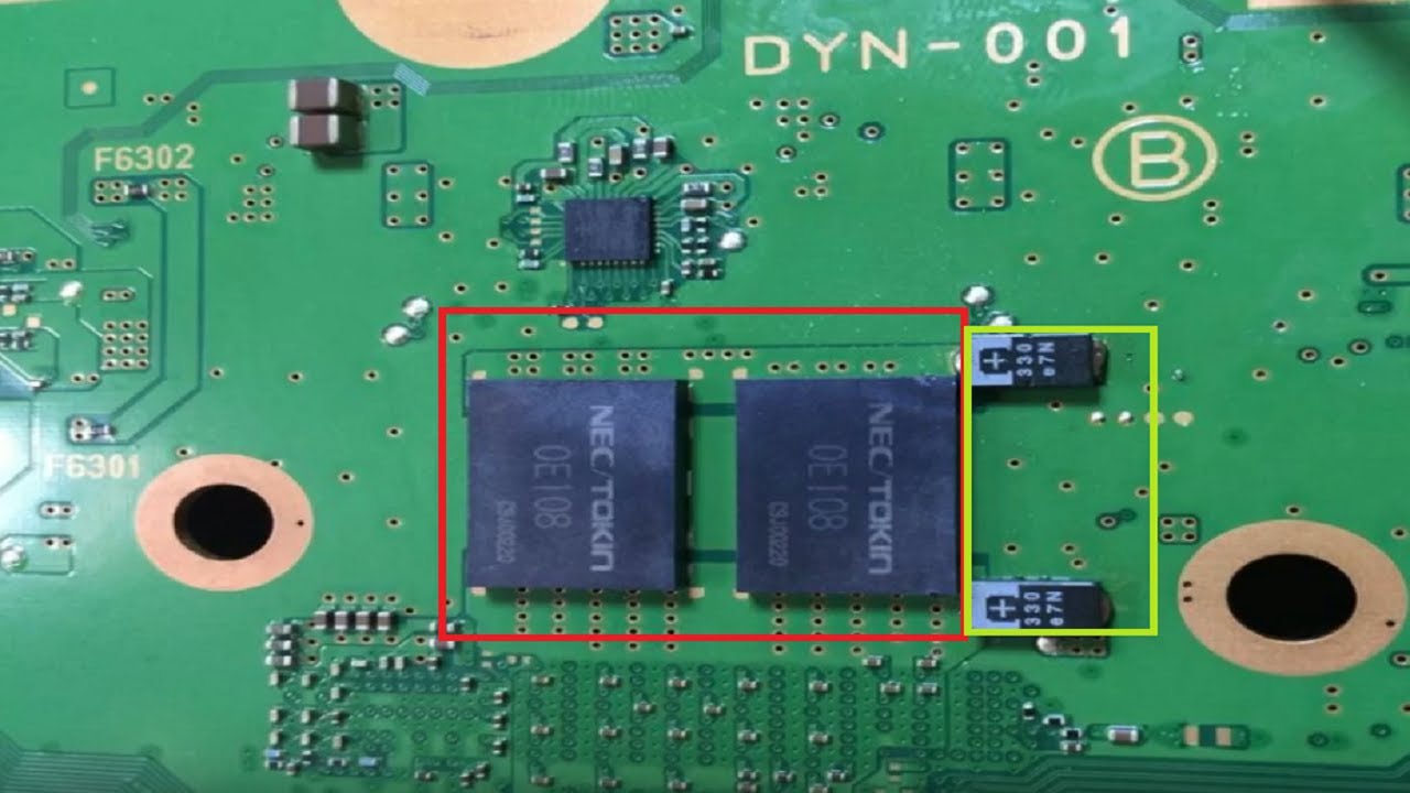

Your NEC tokins are going out.
You can fix it easly without replacing nec tokins, since those are somewhat still working you can just add 2 tantalum capacitors (330ohm or 470ohm) near RSX tokins (piggyback method).
I've done this on multiple consoles and it works great.
